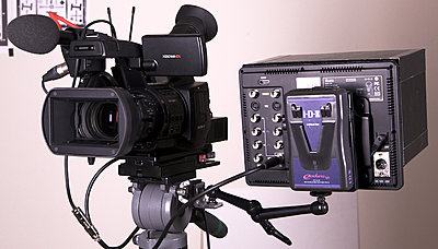

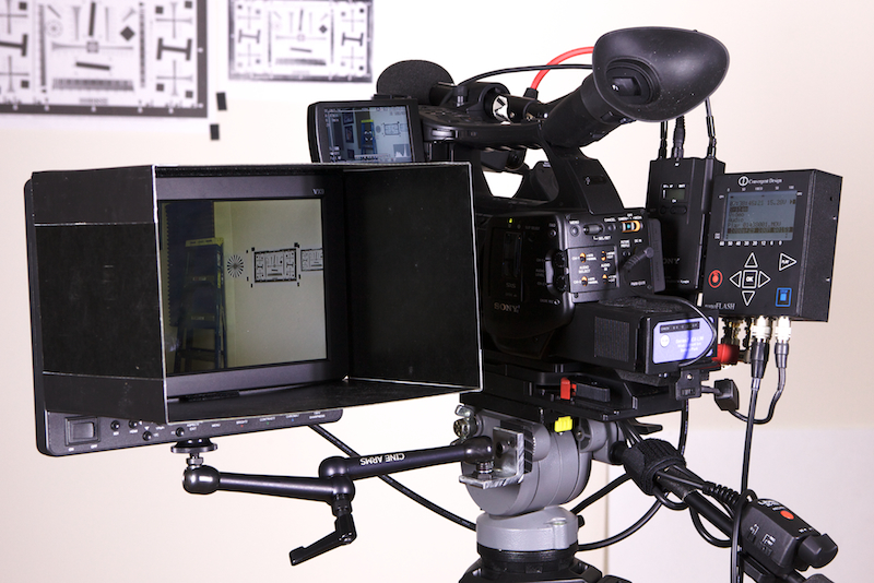

Here are a couple photos of VX9 on a EX1R in the Studio configuration.

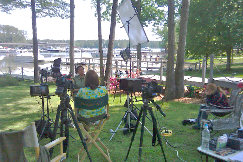

Here is a cell phone photo of a recent shoot showing how I use monitors on a 2 cam shoot with 1 operator, in SC.
The 7" mon is right in front of me, and the 9" is about 6' away allowing me to keep a close eye on both cams. These are very long shoots 8 hrs or so with a number of interviews, and the A B cam system works great for editing later. The Cams are an EX3 and an EX1R. Notice the really alert intern Emma on the right.
