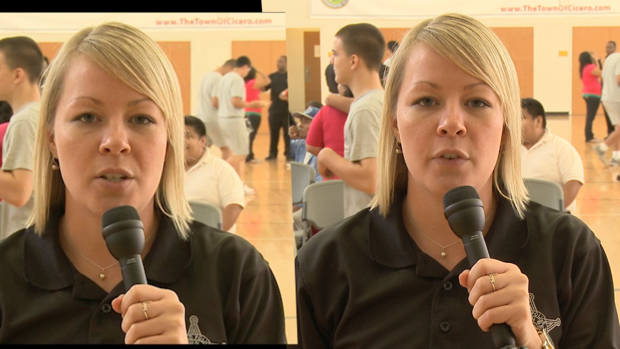

See attached image. On the right is the original XDCAM EX MP4 shrunk down a little within After Effects and the left is the encoded video out of Premiere Pro CS5 which is H264 720x406 @4Mb/s average, and is increased in size within AE to better match the original. I exported as a Tiff sequence and the attached image is directly from that.
EDIT: I added a PNG so it can be viewed within the website.
