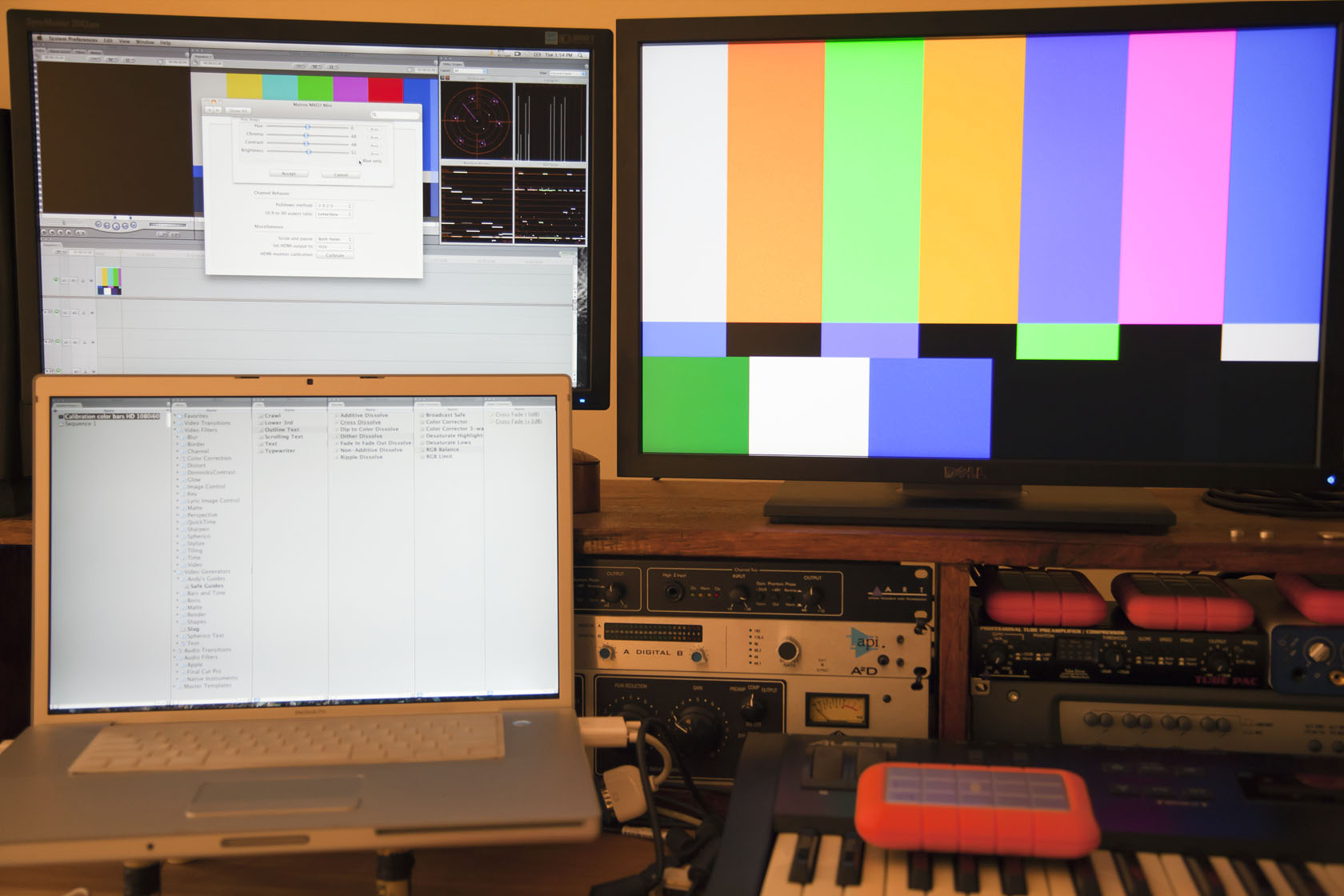

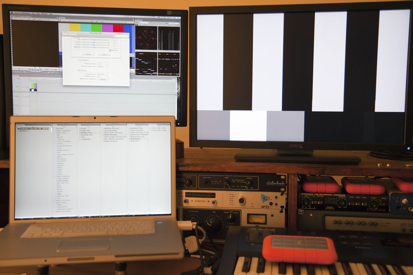

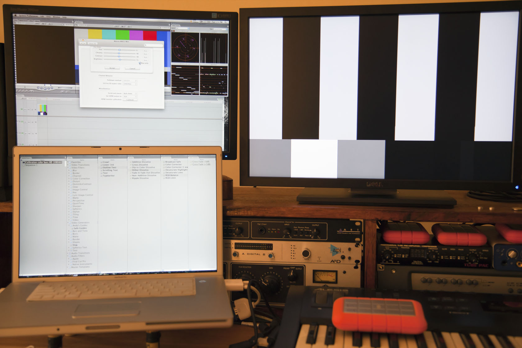

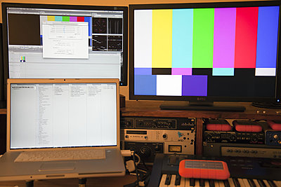

here is what i am talking about.
photos of Matrox mini (firmware 10.0 on OS 10.6.4 in FCP 6.0.6) color balanced monitor and blue only ('all colors 1' and 'blue only 1').
then i crank the hue and saturation to 100 on the monitor, and still the blue only shows a perfectly calibrated monitor ('all colors 2' and 'blue only 2').
so how can the Matrox blue only be an accurate way to calibrate a monitor, if it does not reflect the radical change in the colors that the monitor is showing?
am i missing something?
Matrox does not calibrate monitors?-all-colors-1.jpg   Matrox does not calibrate monitors?-blue-only-1.jpg
Matrox does not calibrate monitors?-all-colors-2.jpg   Matrox does not calibrate monitors?-blue-only-2.jpg
