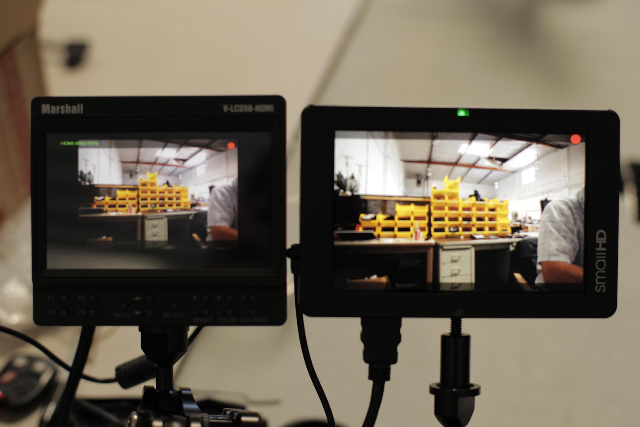

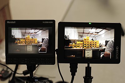

One thing that really strikes you is the ability of the DP6 to scale the image up to fill the screen (via the DSLR preset). This makes for a notably larger image, as seen in the first picture below. In this mode, hitting the record button on the 5DMKII will still cause the screen to blank for the typical 4-5 seconds, but when it returns the image size is exactly the same, not squeezed which is a great advancement. The 5" has a similar function (accessible via the HDMI auto mode); it maintains the proper aspect ratio but it shrinks the image another 5-10% or so. See second picture (note the position of the frameline compared to the HDMI lettering in green). Since the 5" is already a smaller screen to begin with, it starts to feel like one is losing the battle in image size--from a typical operating distance it will become tough to judge focus and see details. PLEASE note that I appear to have taken the second image from an angle and focus is not good--the intent of the picture is to show the relative image sizes when in record mode; don't start drawing conclusions about screen sharpness from these.
While the DP6 has significantly better resolution specs, it's interesting to note that the monitors appear to resolve similarly, perhaps because of the magnified image on the DP6 in scaled mode. I was able to judge focus on both with about the same level of distinction.

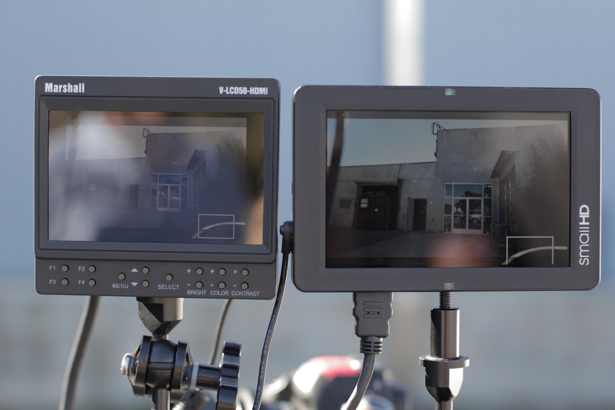

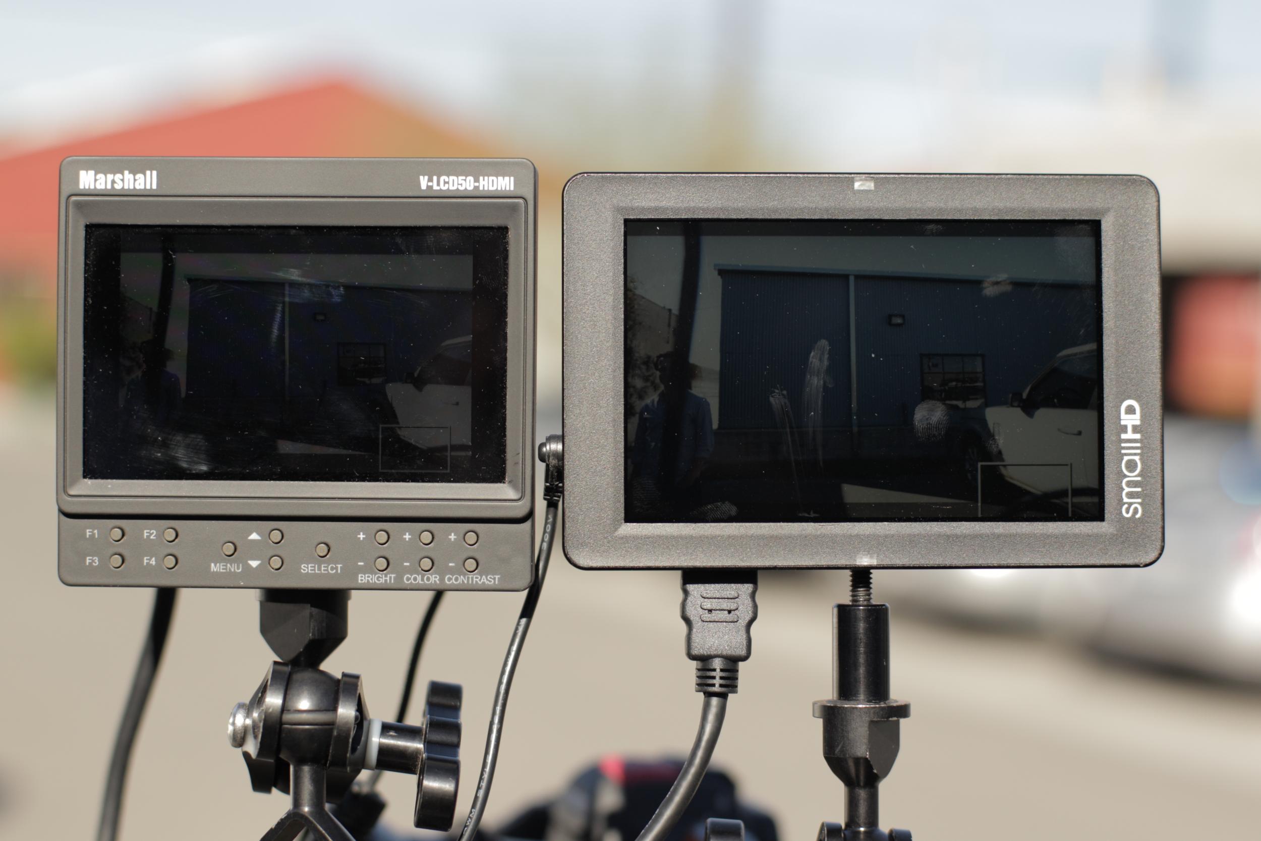

And here we are outside in the bright California sun. I should point out that it is a bit of folly to take photos of monitor screens as the camera "sees" them differently than the eye; these looked more washed-out in person. Still, the relative differences between the displays remain and you can see that the DP6 wins on this front, as the anti-reflective coating rejects a certain amount of daylight creating a bit more contrast. I could barely see any image on the 5" while the DP6 had just enough to make out outlines. Again you can see the effects on each screen--the orangish glow on the bottom right of the 5" is repeated in the center of the DP6 with much more transparency. While many are tempted to use a straight hood of the type that SmallHD offers, this won't help the reflective aspect any and you end up peering at a image of your own face. You are far better off using a Hoodman-style angled hood, which you can fashion yourself out of coroplast with a bit of trial and error.
The first image is shot with the sun behind the monitors, while the second has the sun striking the face directly. Obviously this is a worst case scenario for any monitor that is not designated as daylight viewable and these fare about the same as most, although you can still see that the DP6 has a marginally better image under these circumstances.
While I like several aspects of the Marshall, including the slightly better image quality and the inclusion of four easily accessible function buttons (and front panel image controls), I have to give the thumbs-up overall to the DP6 for the image size, customizable feature set, build quality and other features noted here. For me, buying a monitor with HD-SDI inputs is a must due to the varying cameras I use so the 5" is not in consideration. When one compares the size of the DP6 to the Marshall 6.5 or 7", those two units seem like behemoths. I feel like the DP6 is a sweet spot in size for an onboard monitor for my application. For those using a bare DSLR body with lens, I would think the 5" might be a more appropriate size. Both are very impressive and a great step forward for both companies; it's amazing to see so many useful features packed into such small and inexpensive units.
DP6 vs Marshall 5" - first look-backlit.jpg   DP6 vs Marshall 5" - first look-frontlit.jpg
