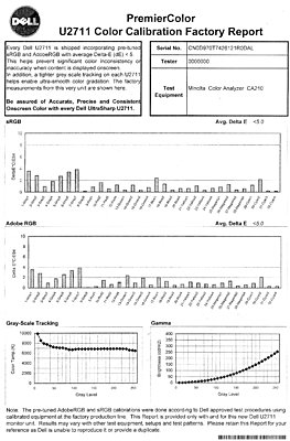

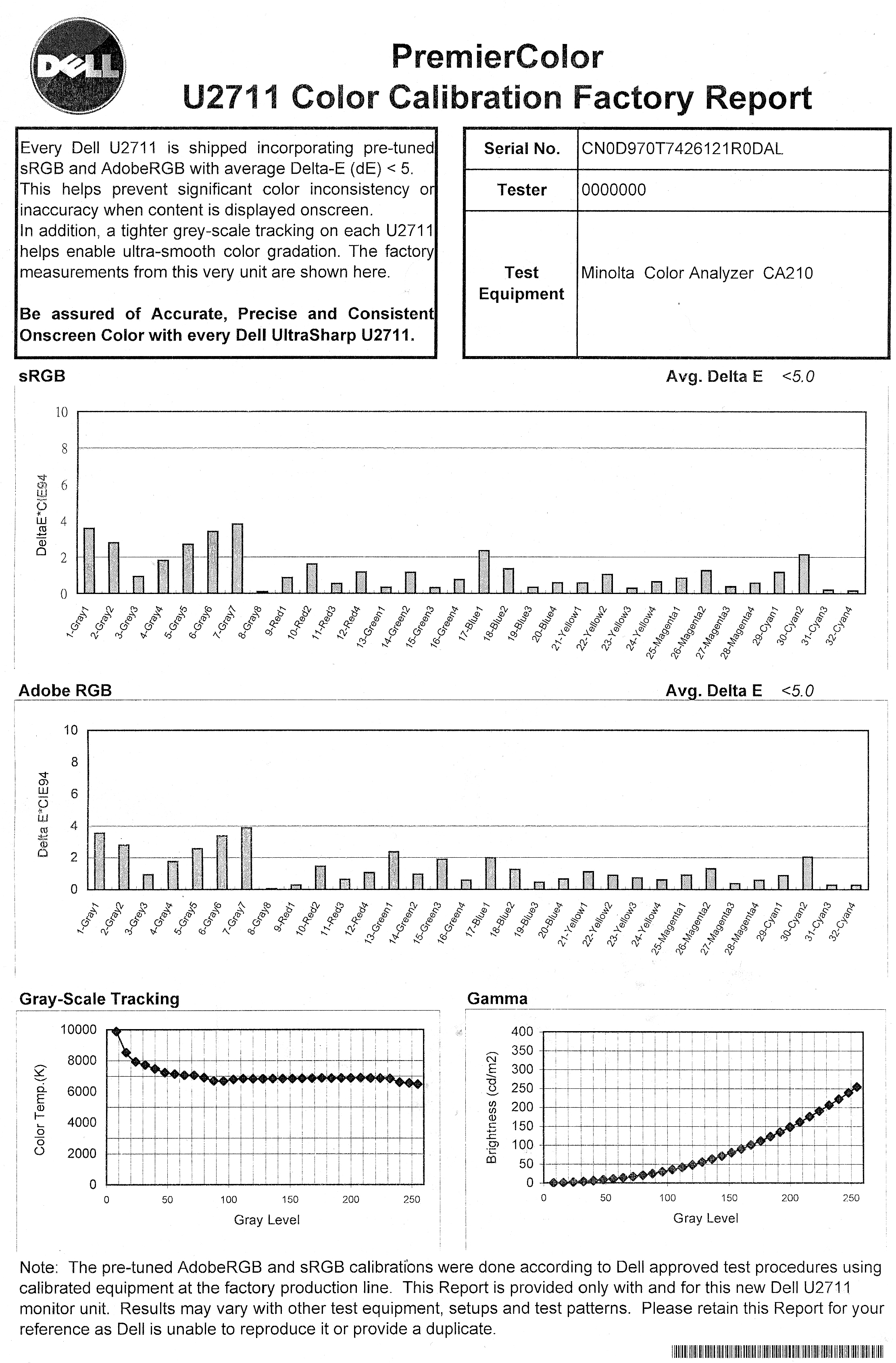

Old January 1st, 2013, 06:04 PM   #42
Posts: 3,698
Images: 18
Re: Calibrating for video accuracy
This throw any light on the Ultrasharps?
CS
PS: That any better?

Old January 1st, 2013, 06:51 PM   #44
Posts: 3,698
Images: 18
Upload updated. Got it as a .gif too if that's more usefull.
CS
Old January 1st, 2013, 06:59 PM   #45
Slash Rules!
Join Date: Apr 2002
Location: Houston, Texas
Posts: 5,472
Thanks. Not sure what all that means, exactly. I'm guessing it's good.
