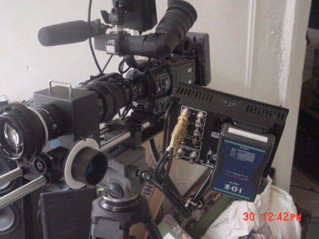

hd100 +marshall
i got mine mounted to the tripod , check it out .

Jamal - Where did you find the arm/bracket to mount the monitor to your tripod? I really like that set-up.
Law
sorry for the late post but i got it from zgc (jason)
