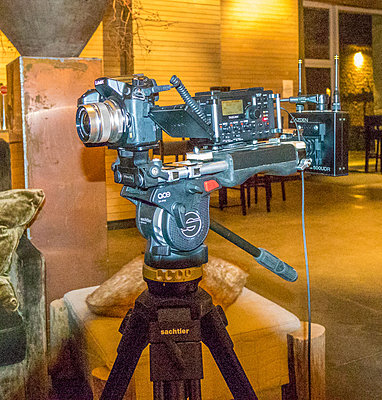

And for those who would find this interesting, here's a pic of my setup during teh interviews you see at the end of above video (can be seen after the couples name appears.)
I used the gh3 with a dr60 feeding the sound directly into the camera and a backup into the dr60 itself. Although the weight distribution is quite off centre the dr60 and my azden wireless receiver are very light, my tripod doesn't even know they are there :) I love using that azden udr500, I got it second hand and until now I never had it loosing a signal, those 2 antennas sure have been doing their job right so far. If I have to shoot handheld with this setup I also would attach my varavon loupe which make me use it as a mini shouldercam.
