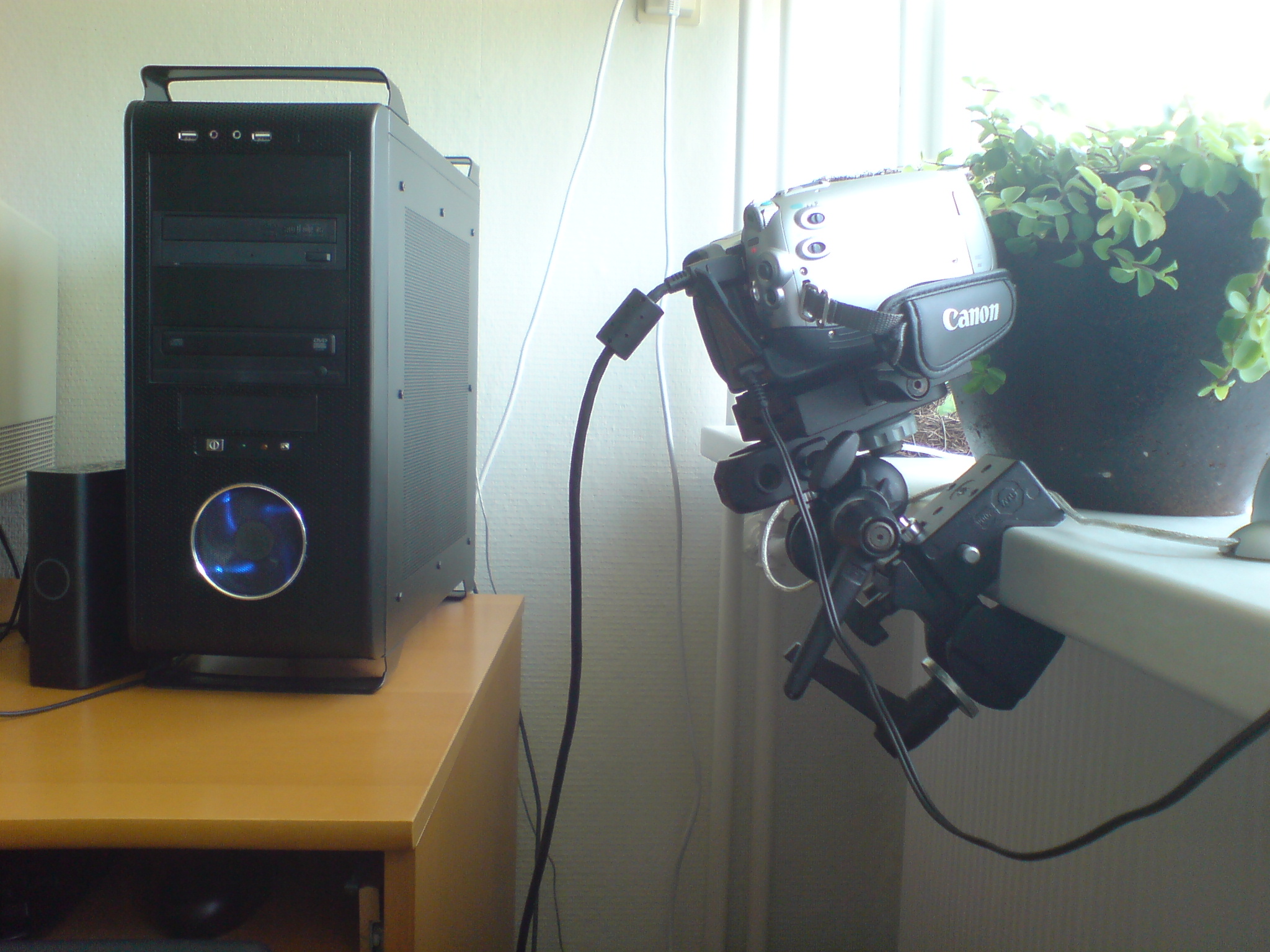

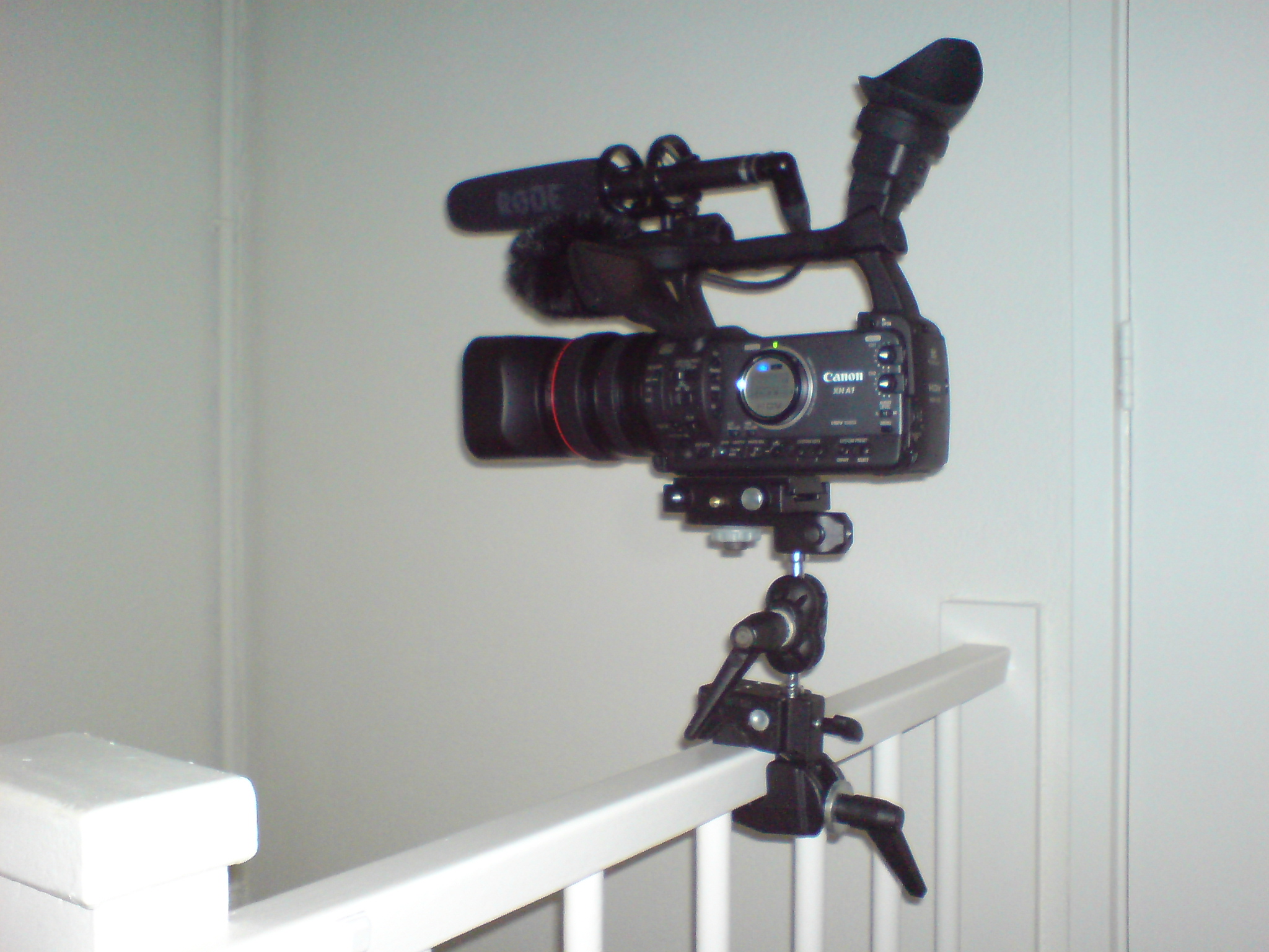

I use the Manfrotto superclamp (035) with the double ball tilt top head (155) and camera bracket (143). You can clamp it really tight. HV20 is never a problem. Used it outside cars at really high speeds on bumpy roads. For static support a Z1 will work, at least it can take the weight of an XHA1, wich i guess is about the same weight. It is the max for the ballhead, but it can hold the weight.

The pics are just fine, as a matter fo fact they are great.
Thanks for the info.
