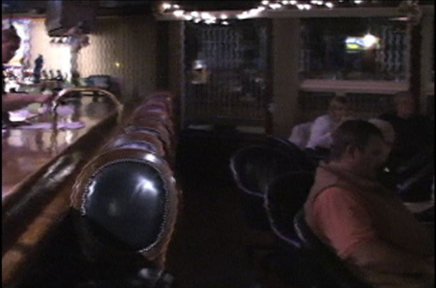

Bright windows - exposure nightmare?
Hi
Ran across this recently. What's the proper way to handle this?
Dark bar, little ambient light. No extra lights
they can turn on. Bringing my own lights would have been intrusive. In addition, there's a wall of bright sunny windows.
Changing the shot to the other side of the room wouldn't have looked good although it would have reduced the bright exposure.
On top of that, I noticed that the camera gain (pd170) kept searching no matter what I did if I moved away from the windows. You could then see the wall change exposure. I didn't see menu settings to turn that off but there's got to be a way to do it somewhere. Putting it on 'hold' didn't work either.
Eventually I solved the problem by shooting it at night. But what would I have done if that was not an option? The exposure difference was pretty great. Had I blown out the windows it would have looked like they were being abducted by aliens. lol
thanks

Ok. What exactly would I do to do that? And what's CTO?
Q - Wouldn't ND cut the light to the point that it all would be dark? I'm already opened up at that point without the ND because of the dark bar. I think my shutter speed was at 60 so I couldn't go much lower. I'm not sure what the actual exposure was though.

So the solution then would have been to actually tack up large sheets of gel on the outside? Wow. OK. I didn't even think of that. It was en entire long wall of tall windows, not just a few. That's a lotta gel!
As for manual exposure, I thought that's what I was doing. That's why I was surprised (and frustrated) to see it searching. Then looking at the footage of the shift, it became apparent by looking at the data code that it was actually the gain that was searching. It was set on zero in the past and I assumed it would stay there until I changed it as long as I wasn't on full auto.
I was concentrating on the other exposure elements and forgot all about the gain as a factor, thinking it was off.
The way I've been exposing is to set the shutter speed at 60, zoom in to an area, push the iris button once so that it shows on the screen, then adjust it if it looks like it needs to go up or down a half step based on conditions, but most of the time that seems to work fine without much tweaking. I wonder if that's a lazy way to do it though. Shouldn't I be learning to expose without relying so much on the camera to set exposure? Well maybe not.
For white balancing I've usually just been picking the middle of the room where both color temperatures mix, and doing a manual white balance there. Is that incorrect?
Kell Smith is offline   Reply With Quote

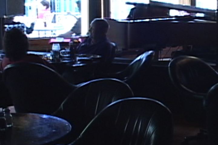

here's the exposure I ended up getting. It's still a little bit dark. But there were absolutely no other lights they could turn on. I suppose I can lighten it a bit in post.

Actually, there is another option: using a day-light balanced on-camera light (there are plenty available...) In situatons like this, with my PD-170 I use this light: S-2010 On Camera LED Light with S-7200F Bracket for Sony . It could help to reduce the contrast and it could be easier to white-balance, of course, everything on manual...
Thank you.

I suppose the on camera light would work in static shot situations. Mine isn't daylight balanced but I could tack some gel over it.
In this case though, the camera was moving as I was panning the room so I assume that would be a problem. You know what, I've never even used that light? Maybe it wouldn't.
