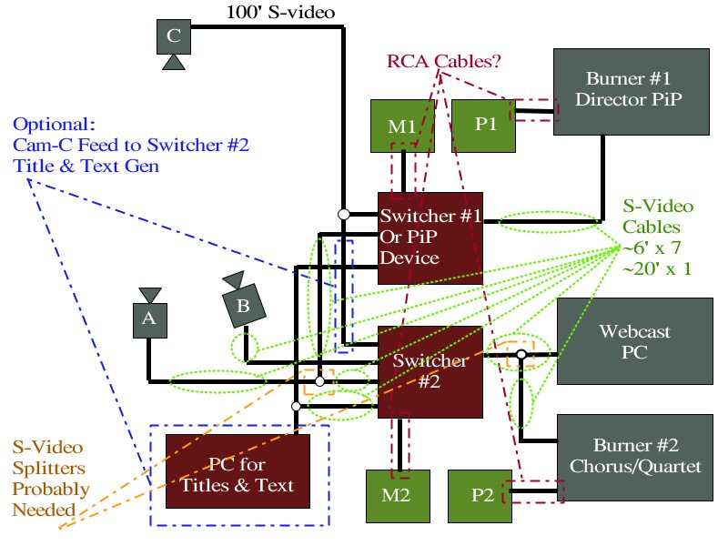

I am prepping for a three camera live switched & live streamed shoot (unfortunately is is a mostly pro-bono job for a club I used to be a member of..... but it will pay for the additional gear I need,....... yeah yeah... I know.... bad habit to still be in). The deal is I would get all DVD sales ($10 each expected a max of about $620 in sales - 28 quartets 16 choruses).
Should be quite hectic. It is a regional choir competition (competitors all the way from Alaska, Western Canada and the Northwestern US). The event chairperson has the following requirements (some more wishes than requirements).
1) Each quartet gets a DVD of their performance by the end of the competition.
2) Each choir gets a DVD of their performance by the end of the competition.
3) The Directors in the Chorus competition get a "director PiP" cut that has a camera facing them so the director can see how the chorus responded. This may or may not need to be done by the end of the competition (in other words a post-production edit may be ok).
4) The Quartet, Chorus, and show of champions is broadcast live via webcast (I'm not doing that part, they already have someone volunteering for that).
5) The district Org gets an archival copy of the entire competition for training future judges.
The real fun (and complications) comes as a result of requirement #3 and the organizer wanting to have switched cameras for #1/2 and not just a single static camera (static split screen would be ok, but I don't know how to do that with out it being a transition held 1/2 way on a real switcher).
The entire production wouldn't be too bad if there were two cameras (one dedicated to webcast and one for burning), or even just one camera total and an s-video splitter to send the signal to both. The org chair is trying to raise the production value from previous district competitions (held in Alaska, Surey, etc) a bit to get greater participation and make a good impression for our state's chapter.
So essentially I need a switcher, a few 100' s-video cables, a bunch of monitors, and live DVD-burners.
I am currently planning on picking up (somehow) either a Videonics MX-1 or MX-3000 on ebay (currently the only place I can find them). The Videonics units require one TV to preview & view the working surface (which cam is up next, what transition is active, etc) and then one to view the final output (after running it through the DVD recorder).
My questions (at last) to the DVInfo community are....
1) How long can an s-video run be before it needs a signal booster? NewEgg has a 100' cable, but there is no way the stage is any shorter than 150' from the back of the auditorium where it is likely that our cams & switcher will be.
2) Any personal experience with the videonics units? Alternate multi-input synched switchers?
3) Any experience with live DVD burning devices. I'm looking at the TOSHIBA D-R410 That seems to be the cheapest DVD burner. IT has the bonus of also being an upconverter and it can (theoretically) burn at longer play times (up to 6 hrs if it scales down to 320x240 from 720x480, but I wouldn't trust the compatibility on that setting)
4) Anyone with experience doing this care to comment on my plans? I have some, especially given the recent long thread about live events as they relate to live wedding reception broadcast. Fortunately there is NO post involved in this shoot (unless I need to for the Director's PiP).
See the attached schematic for a potential layout (if there is the ability to have the director's cam signal get back to the AV table that is).

Sounds like fun. Just some ideas from my experience-
-I've run 200-300' of S-Video no problem for a variety of events.
- Check out the Sony MC5 Sony | DVDirect MC5 Multi-Function DVD Recorder | VRDMC5 | B&H It has a built in confidence monitor. Pretty sure you can find it closer to $100 if you look around.
- I've also used Tricaster switchers. Pretty neat. They take 3 inputs and put everything on one screen for you. They also stream live outputs. NewTek | Tricaster Live Production Studio | TC000000-0101 | B&H
Good luck, sound like its going to be quite a time.

Fortunately for me, all web streaming will be taken care of by another individual, so I do not need to arrange for it. Unfortunately for me, I'm not going to get paid any more than the possible max DVD sales income, of $620.
So in order for me to even be able to do the job, I need to keep my equipment purchases below that figure. Preferably, much further below.
That is good news on the svideo cables then. Now all I need to do is figure out of the event staff will run the cable, or if I need to.
Jason Robinson is offline   Reply With Quote

In theory you need to boost signal after 50 ft but that does not mean you can't go beyond 50 ft, i've seen 100 ft runs without problems.

Interesting. So throw the dice and hope it works? I'm not a fan of that style of event production. Can a composite video signal travel farther with out problems than s-video?

I can attest to the cat-5 and Baluns connectors solution - use it all the time for runs over a hundred feet.
Videonics are okay - but used units can have hidden flaws. Might not show up till they've been on for a little while. Basically, buying a used switcher is going to be dicey unless you have time to give it a thorough shakedown before hand, so make sure you get a return policy and enough time to find another one.
Tricasters are great but out of your budget unless you can rent. Find out if that's possible.
