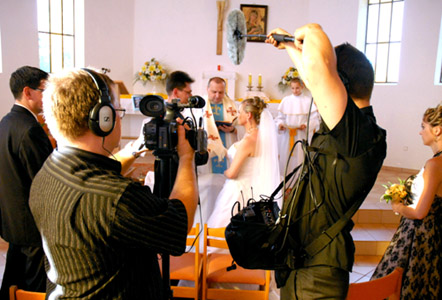

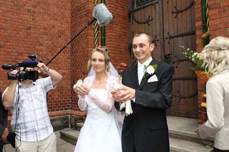

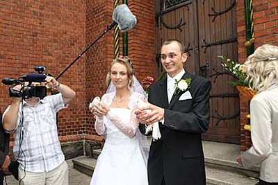

I found the answer on EBay - a blimp from India, they even include pictorial evidence that it's fine for wedding use!
How's that for unobtrusive? and with the soundie next to you you have the added benefit of completly blocking the photogs shot!

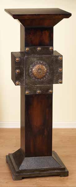

I just have to make it invisible.... so what about a small slim stand with a wedding symbol on the front that widens out as it reaches the top (maybe some space to put flowers)
From the guests point of view it's a white stand that forms a focal point between the bride & groom - from the back it's a housing for a mike & wind cover that's only seen by the celebrant, bride & groom.
K-Tek | Windscreen - Slip-On Windscreen (Tiny) | Z-FSO-T | B&H
I've attached a couple of images of the shape I'm thinking of - if the basic design is right it will look like it's meant to be there. at the right height & size it doesn't obtsruct the ceremony and 'goes unnoticed' Of course you'd have to show them at a rehearsal so they were comfortable with the idea but I usually attend those anyway.
Am I way off the mark? - is it worth developing the idea?
let's not get hung up on the 'right' mike or blimp - I just want to put the general idea out there to see if it's got legs.

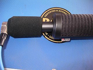

Try a Rycote Mini Screen and windjammer combination, Rycote - Miniscreen by far the most effective solution I have ever used for on camera mics. I can film on the wild North Cornwall cliffs, and all but kill any wind noise. Dont forget to cover every joint, switch, xlr point on the mic with tape, or foam. These areas, left uncovered will render any wind protection you may have useless.
