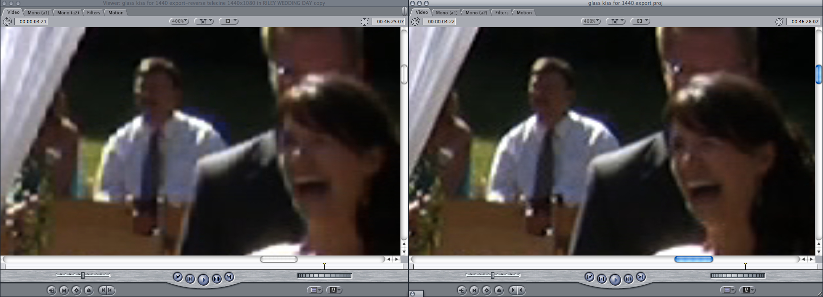

Hey Travis,
Originally Posted by Travis Cossel View Post
...You probably already know this but you can use compressor in FCS to convert the footage to match the 24p frame-rate of the 7D or T2i. Not sure that everyone does this and that can make the footage look different.
I do - mostly because you couldn't use the HV30 clips with the XHA1's footage in a multicam sequence unless the frame rates match up - though the HV30 is shooting 24p its wrapped in a 60i container. The HV40 fixed that.
For a better looking conversion (fewer edge artifacts) I use JES:
Home Page of JES
But the workflow isn't a smooth. Below is a comparison of Compressor (on the left) and JES at 400%.
I also I have a Compressor droplet linked below if anyone needs it - converts 24p/60i to native 24p via Reverse Telecine.
http://tinyurl.com/45akmx3
