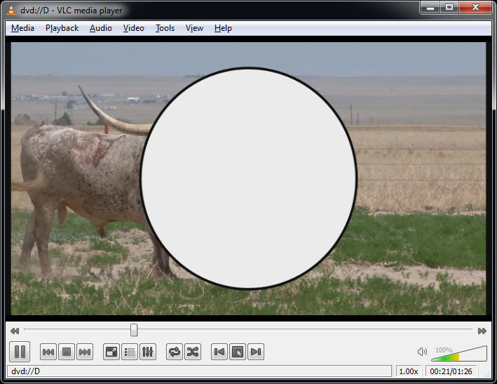

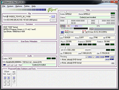

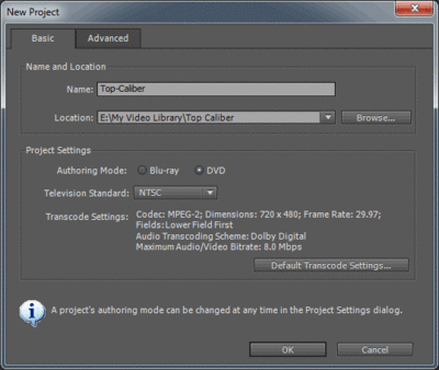

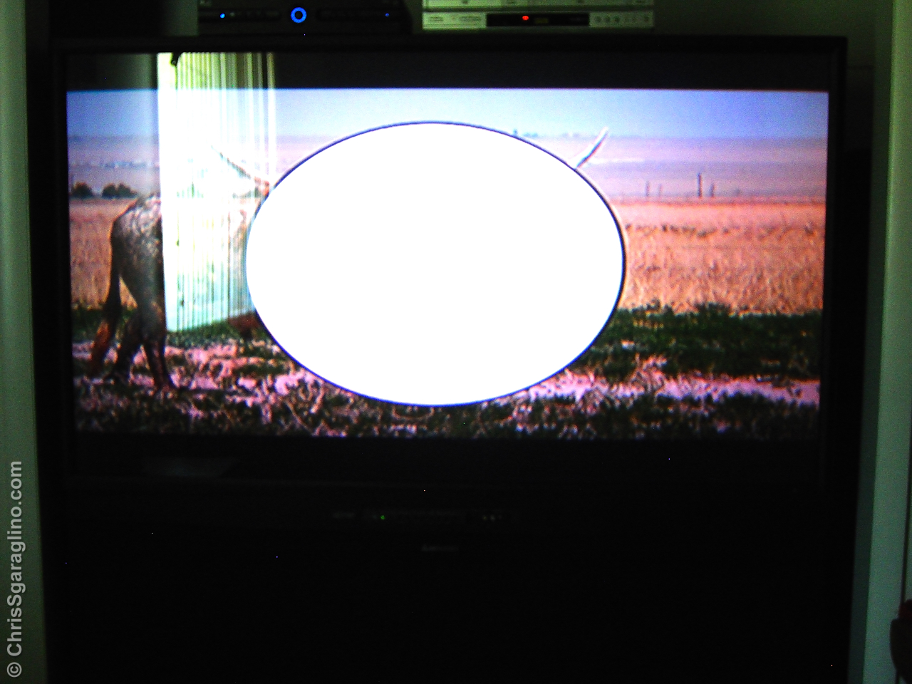

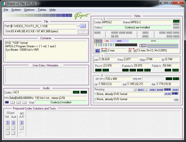

I took some images form another DVD/Video that I am also trying to produce and added a white circle to it from Photoshop.
Image 1: Encore Settings (I did double check to make sure Encore is set to 16x9)
Image 2: What is looks like on my 55" TV
Image 3: Media Information
Image 4: How the "same" DVD looks when played on a computer with VLC

Chris, you'll have to wait for someone who knows more about your software than me sees the post I'm afraid but image no 2 looks to me suspiciously as if the TV has been set to super wide or some similar description for showing Cinemascope-type (2.35:1) films.
Philip Howells is offline   Reply With Quote

This might be a silly suggestion but it has happened to me!!! Go to the DVD player and push the setup button on the remote and make sure that the player aspect is, in fact, 16:9 and also zoom is disabled. I have had 4:3 videos stretched out by wrong player settings and also 16:9 clips squashed or completely distorted just cos the DVD player setup was wrong.
VLC plays full screen by default so also check the vid on your puter with VLC normalised and make sure it too, isn't stretched.....also I assume you did render this to an SD setting like 720x480 16:9 ?????

Your transcode default settings are incorrect. Setting your resolution at 720X480 will make for overweight brides, something they really frown on. Try 1280X720, you and your bride will be much happier.
Dave Chilson
www.loc.org
David Chilson is offline   Reply With Quote
Old June 23rd, 2011, 05:24 AM   #9
Join Date: Mar 2010
Location: Midlands UK
Posts: 699
Re: Bride is FAT on DVD!
Originally Posted by David Chilson View Post
Chris,
720x480 (NTSC) is correct for DVD.
1280x720 maybe for Blu-ray or other media but not for DVD.

This is correct, which makes me think it's a pixel aspect ratio thing. I don't recall the correct pixel aspect ratio for widescreen 16:9 dvd, so someone correct me if I'm wrong, but is it not 1.2?
The pixel aspect ratio for 4:3 DVD is .9, so if you can find this setting somewhere and see it's either .9 or 1, then I would wager that is likely the problem.
Hey Chris - this did it... It was way deep into the Advance Video Settings!
