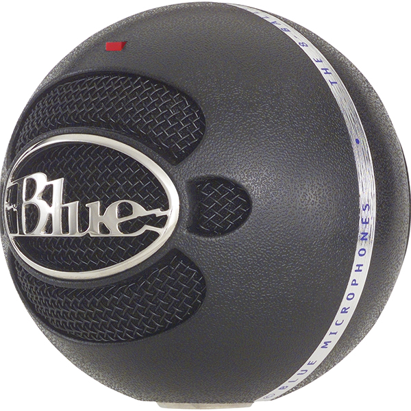

I knew I'd seen an "all round" mic somewhere :-)
But more seriously, using a stereo mic like the Rode Stereo Videomic can cause unexpected problems. Have a read through this thead if you haven't already seen it http://www.dvinfo.net/forum/all-thin...o-xlr-mic.html

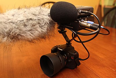

I've yet to really test it much (other than making my wife sing the ABCs a couple times!), but I think I may have a solution that will work well. See picture below. I'm obviously not breaking any new ground, as this is a huge part of what a juicedbox does (mixer), but I am just putting the shotgun and the stereo mic on, and it seems to be working really well so far. So if I'm at a reception and I want to focus on what someone is saying but there's music playing, I can choose to either turn the stereo mic up or down based on how I want it to sound. Anyone using a similar setup? And thanks to everyone for helping me think this through - you are always so helpful and I can't thank you enough.

I was intrigued and not a little impressed by the sound array you have on top of a relatively small DSLR. I've not seen many in operation and most seem to have a small stereo job in the hot shoe connected directly into the camera by thin cable to minijack - presumably unbalanced. I've not seen any who've taken the wise route you have and put as much effort into getting good sound as they have good pictures. It must certainly avoid the client confusing you with the photographer and his "nearly-naked" DSLRs.
