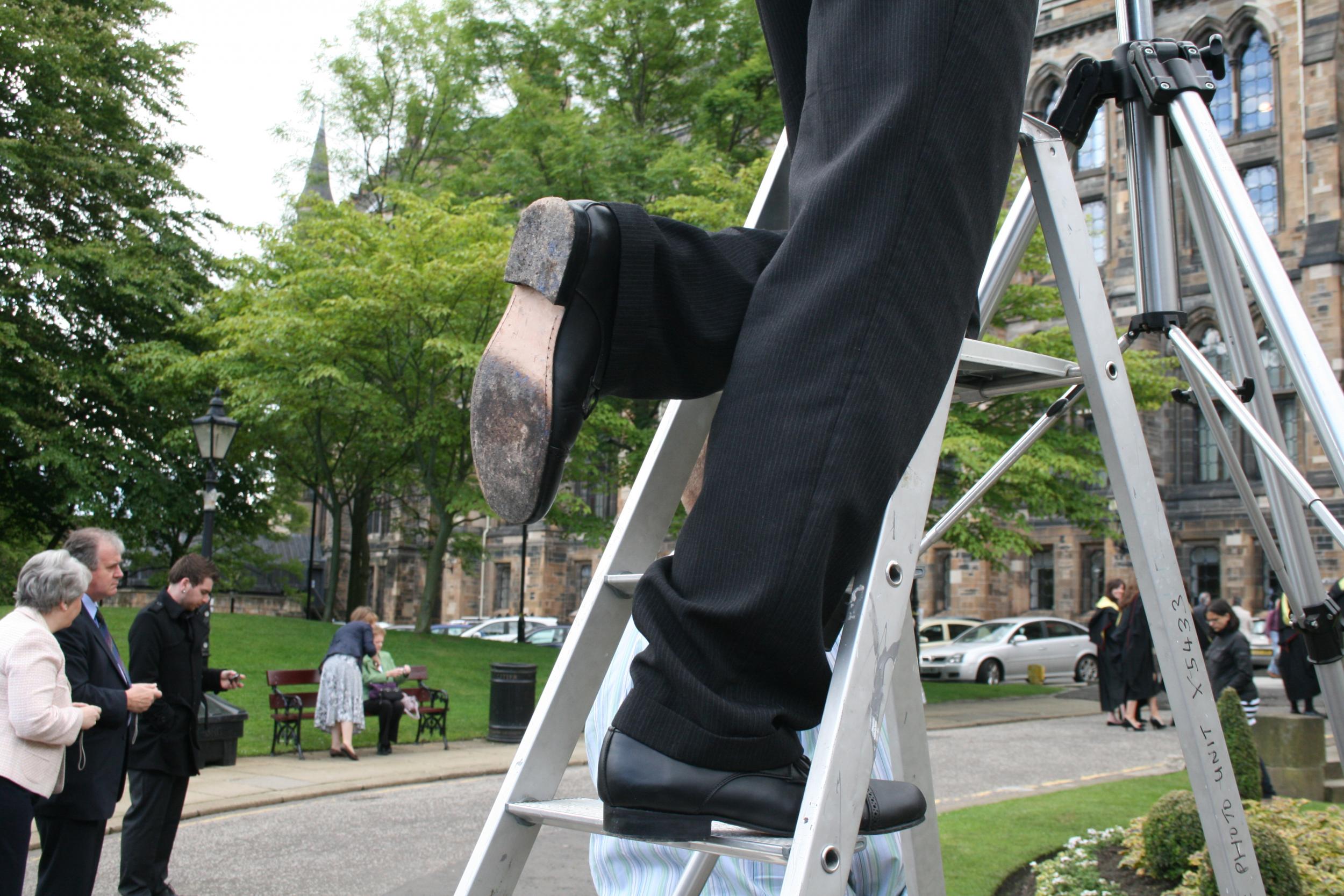

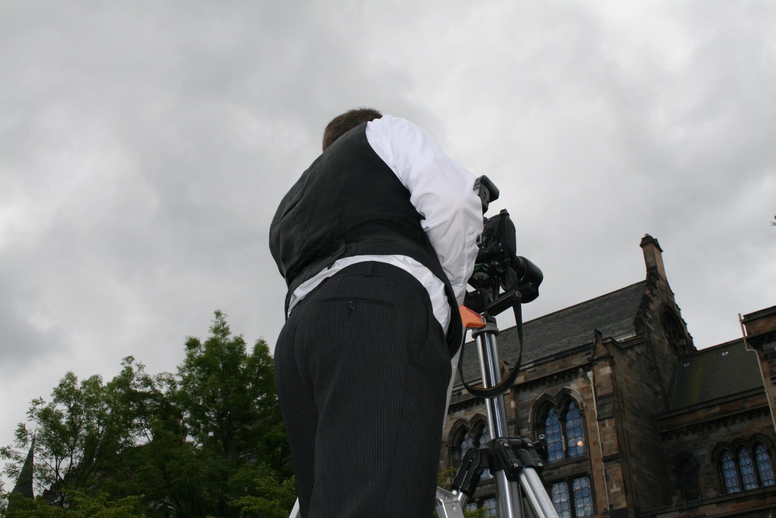

Don't know what this guy was using at a University graduation but the camera seemed to be about 3m off the ground. My better half was amused by the photographer's posture and took these pics.
