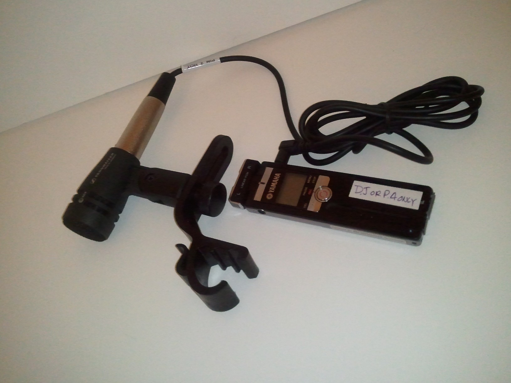

Stephen, Good question, I guess that depends on your MP3 recorder whether or not it has "line in" volume control. I usually set mine to auto gain because I can't be there to monitor sound and record the speeches at the same time. Sometimes the gain is a bit low but I can bring it up in post without too much audio noise. By the way,to recap on my option 3, here is a picture of the set up.
