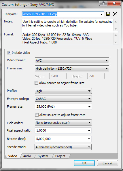

WMV is a really nasty codec IMHO. Best output from vegas for online is to follow the guide here Compression guidelines on Vimeo
For us we use:
Save as type: Sony AVC
Template: We have a custom one but use the 'Internet 1280x720 25p' or whatever frame rate suits you best (were in the UK so use 25p). Then, customize it and change the bitrate to 5,000,000, profile from Baseline to high and on the audio change the bit rate to 320,000, we leave the audio at 48hz otherwise we get some funny sound problems. On the project tab change the quality to best. Save that as a custom vimeo/youtube preset.
Also try this to solve your highlights issue. Apply the broadcast filter to the entire timeline and select the lenient preset. Then.... here is the magic bit. On the luma move the smoothness sliders all the way to the right. You can leave your min at 0 and max 100 but the smoothness will do some magic. Leave everything else as is.
Also, Im noticing some major motion bluring on your footage. Are you shooting in 30p and then converting to 24p when you output?
How to get colors to POP in weddings (similar to StillMotion or Travis Cossel)?-vimeo.jpg
