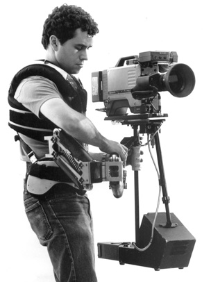

Theoretically it could be possible to get away without side to side balance if everything is truly square on the rig. In reality, EVERY rig has a certain amount of play and "gremlins" that will require one to fine-tune to achieve perfect balance. The Glidecams are no exception; in fact they are known to have non-linear gimbals which cause the rig to lean one way or another when you rotate the rig 90 degrees.
Over my 25 years in the saddle I owned something like seven rigs, starting with Model 1 pictured below (damn, was I young) which didn't have side-to-side adjustment--you swung the battery on the sled left and right on a pivot--up to the latest and greatest. Every single one required trimming even when nothing had been altered on the sled. The classic ritual of a Steadicam operator before a shot is twiddling the knobs; it's a given. I got to the point where I would do it while walking from the dock to my first mark, even after lens changes where I'd have to adjust the gimbal, check drop time and tweak the top stage, right up to the slate coming in.
My experience is far more limited with the smaller handheld rigs like the Merlin, Glidecam and Blackbird but I've certain played with them enough to know that they are even more critical to the nuance of balance. I long berated the Glidecam guys at trade shows about their coarse stage adjustments; eventually they incorporated the screw mechanism to allow finer tuning. So the "problem solved" suggestion from Craig regarding a slotted stage wouldn't be a solution I'd recommend to anyone--needing to nudge the camera a millimeter while fussing with all that would get old really quick.
Craig: bottom line is that if it works for you, cheers and congratulations. I'm concerned about others who might jump on this train and find themselves with crippled rigs with no resale possibilities and limitations in functionability. I would suggest that anyone considering this mod analyze whether they EVER find themselves trimming side-to-side during the course of a shoot--if the answer is "no" (again--for me, unfathomable), have at it and report back how it's going for you.
