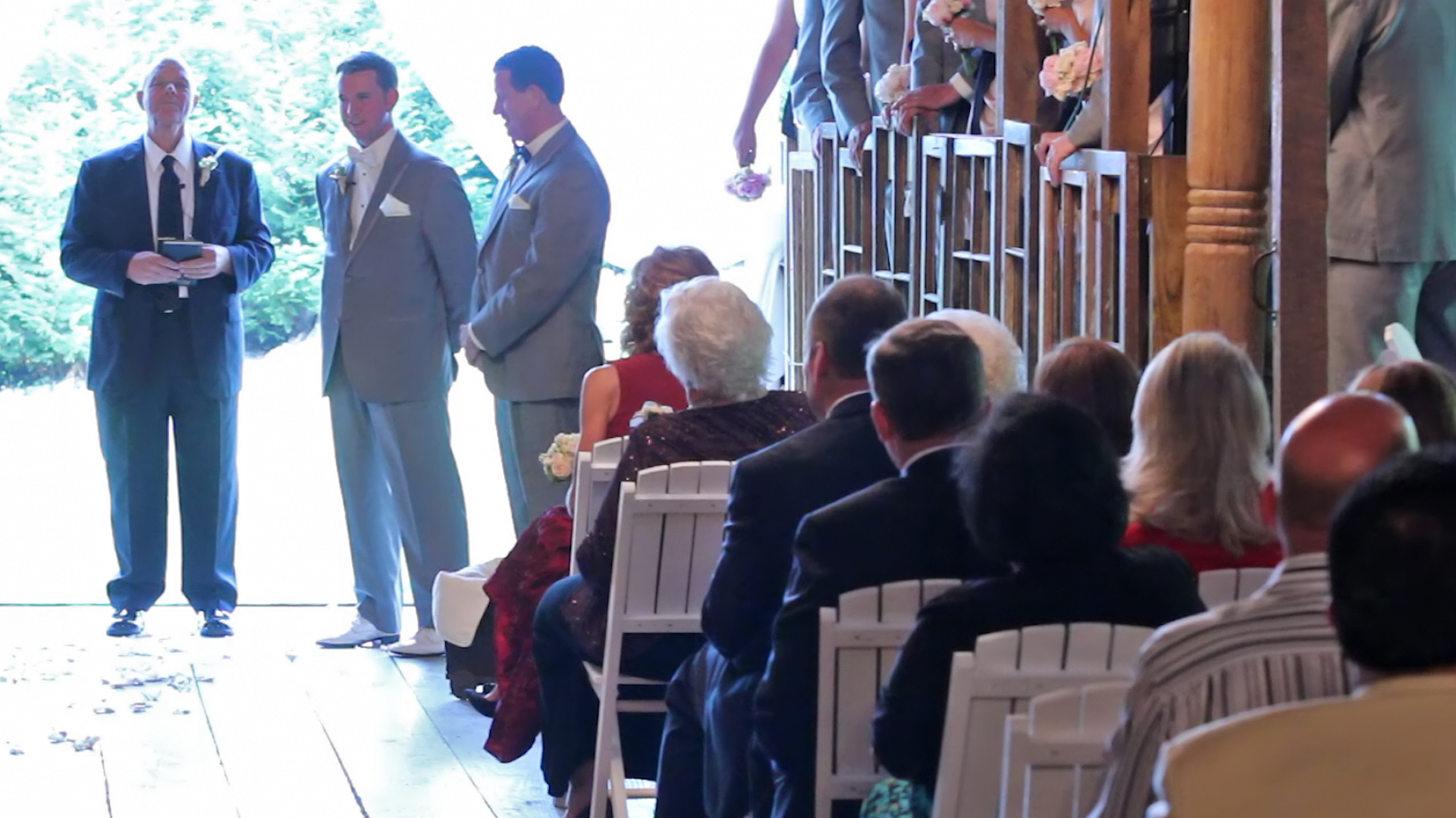

I had a wedding Saturday in a barn. The bridge and groom were positioned at the end of the barn, right by the open doors to the 80 degrees and sunny weather outside. The bridal party were very close on either side, on a platform about 4 feet up, which meant side-shooting was not possible. I had no previous experience with ML HDR (although I will be looking into it soon), and so the attached screenshot is the best I could balance. From what I'm reading in this thread, communicating with the couple about the location is about the best I could've done I guess (in other words, no other technical recommendations)?
The image hasn't been color corrected, although obviously there's nothing I can do with the blown out areas.

Michael, you are absolutely right about informing the bride and groom about the hazards of backlighting. Your situation was pretty tough, for sure.

that's about as bad as it can get as you also have a whitebalancing problem combined with the strong backlight, . Not much you can do about that I guess. About ML HDR I just wonder if that will not cause any flickering in your image?

Michael: You can use your NLE/ grading package to either;
A) put a gradient across the screen that has a lighter orange side on the left and transparency on the right to bring the blues into the realm of white (white balancing is pulling your whites from blue--sunlight to orange--incandescent light). The interior looks like it's well colored (although, you could throw a hint of blue over it to allow you to do a smaller correction on the left side). Make the angle of the gradient match the angle of the front row of people since that seems to be where the images moves from orange to blue.
B) Pull a chroma matte to isolate the blue areas from the orange in the image (you can push the saturation on this matte image to really emphasize the correct portions of the matte). Then, you can white balance just the blue side and just the orange side differentially with alot of control and without having to animate if that frame moves around at all.

Something that I did find which is awesome is that IF your NLE has an invert function (Sony Vegas has this as a plug-in) simply invert the image so the blown out areas switch to dark and then gamma correct it so the background is normal (it will only adjust the blown area) and then invert it again and you end up with just either the dark or light sections of the clip corrected..very cunning...the Vegas forum has a post from me there with how you can save footage here!!.

Interesting, I work with edius and there are some good tutorials online which show edius great potential as a colorcorrector. I realy must give it a try sometimes to collorcorrect just certain parts of the image as I don't have much experience with it. I always try to shoot with the right whitebalance to limit/prevent corrections in post but Michael's example is something you can't get right the first time.

Something I notice at that venue is similar to a venue here that I work at!! You seem to have more bright light coming from the right hand side and there is a bush/shrub on the left...my venue always has bright sky right behind the bridal couple but by swivelling them just a tiny bit and moving my cam position to the extreme right I manage very well.
Now the point is, if the couple have a rehearsal it's always worth going to it and trying out different camera angles and even moving the couple a little bit so you get a balanced background and foreground...that image would have been so much better if the cam was positioned way to the right so it exposed on the couple and the foilage and the left....getting to a venue just before the bride doesn't allow you to discuss options (she's in the limo!!)
I really would have liked to see how much difference it would make if a camera was squeezed in between the guests and wall!!
