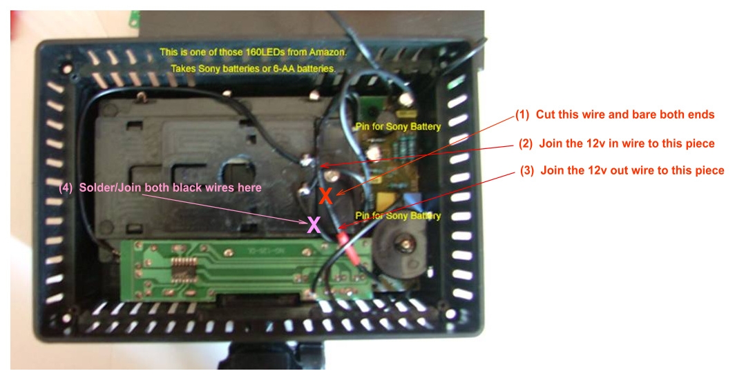

Mark, I use 2 remote lled lights. I got the Logisys 12v 6A remotes. They come with 2 keychain controls and both were different freqs (yay for me ;-). It was a pretty easy install first one I had help---you know who you are ;-) took about 5 minutes and the 2nd even quicker. They work great with the remotes. Oh yeah these came from the big auction place that has an E in the name and were about $17.00 a piece

I have no objection if you mention me regarding wiring the remotes at all. That's what we do here..assist each other!! Mark, If you do buy them you do have to perform minor surgery on the light itself so the remote will work with it. If you need some help with the mod just let me know..it's fairly simple to do!!

Anyway, Chris Harding helped me with the wiring. His explaination made it an easy job for me to cut, snip, solder. I've still got the diagram so if anyone needs it let me know.

Mark here's the pic of the 160 led light. I think it's pretty self explainatory but if you need some clarification I'll try to explain it.
Be careful when cutting and stripping the wires in the light they are fragile. I cut the leads on the remote somewhat shorter also.
