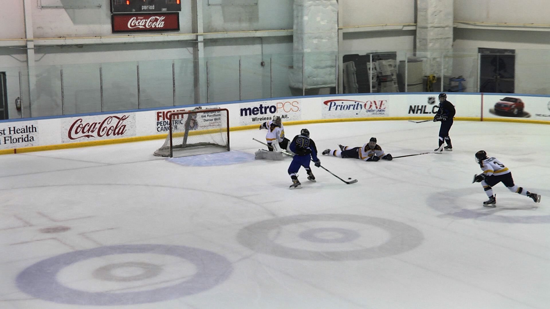

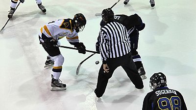

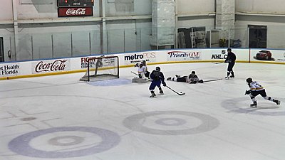

I shot my first game recently. I used Dynamic Range Stretch function on my AC160a to help with the blown out ice. I don't remember what f-stop i set but was it similar to this? - er, sorry can't figure out how to attach.

Okay -Here they are (window was too small, didn't see the upload button on the right.)
Tips for shooting hockey?-04-cypressbay-fo.jpg   Tips for shooting hockey?-04-cypressbay-sticksave.jpg

I shot live hockey for many years and your clips look pretty normal to me. You're not going to get the clarity in your wide shots as you do in the close ups. Now I haven't shot any hockey since moving my system to HD, but the theory is the same. It's the ice. The white ice is going to reflect a lot of light. You can try to play with the saturation on that camera, or the RGB levels to get the colors to pop a little more.

My footage is pretty much the same, only more severe since my wide distance is forced to be much further away. I was thinking the ice would be the issue. I will try the DRS function to see what difference that makes. Also will try adjusting chroma level to see if i get a better match.
