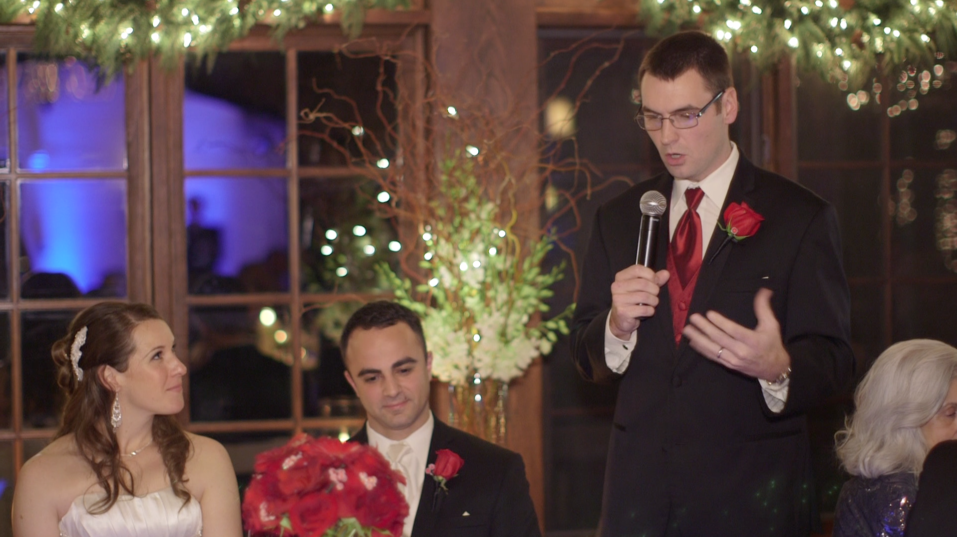

I know what you mean. But, again, when used only dimly/as needed, the on-cam LED is there purely to fill in faces (not for deer-in-headlights look). I find that with great low-light cams like a good DSLR or the C100, all you need is a tiny bit of help and it really brings out your subject (and mitigates a venue's poor lighting). I've never dealt with the exact situation you have here, but I've certainly had the flickering backlighting on the walls. Had I not filled in the primary subject with a little help from the camera fill, the flicker would have been far more obvious.
Attached is one example where a reception venue had some flickery blue-light on one of the walls. It would have even been visible on the faces (of the toaster/b/g) in this image had I not filled in a tad:

Those look like the exact sort of lighting I encountered too ...by me using a fill from the camera light it didn't worry the speaker at all but it basically killed any blue cast that came from the uplighting. It certainly works a treat for me. Due to the physical size of Paul's GH2 cameras he might need a dimmable light on a stand next to the camera, but it certainly works well .... I had the same issue while doing guest interviews as the blue lights had been placed all around the room but just a touch of fill from the on-camera light works wonders ...you still get the nasty blue background on the orginal white wall/curtain but at least skin tones are correct.
