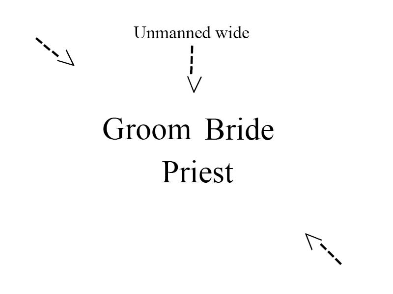

Example 1: The altar-facing manned camera gets the groom's first look, and the audience-facing camera gets the bride's first look. The problem then, if the cameras don't have much freedom of movement, is that there's no close-up of the bride during crucial parts!

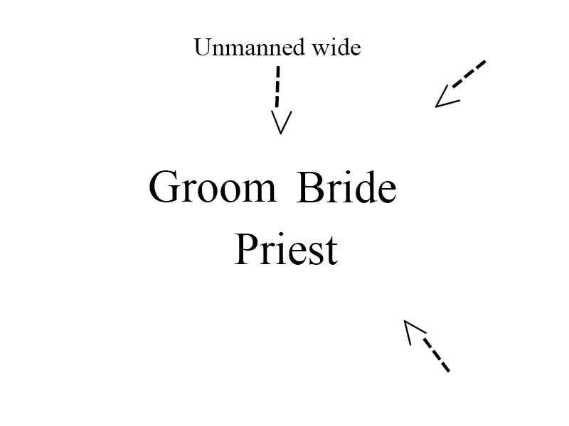

Example 2: Mirror reverse. Now you're favouring the important person. The problems are: (1) groom's first look might be difficult; sometimes the groom even stands side-on, so you can miss the first look entirely; (2) bride's first look might be difficult, because groom and priest might block you; (3) no close-up of groom during important parts.

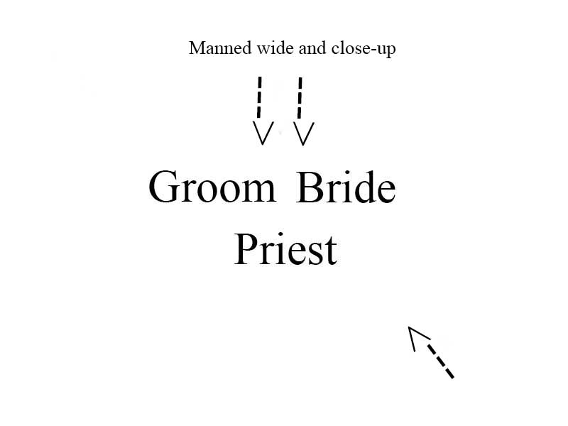

Example 3: Cameras diagonally opposite. You're now set up to be able to get two close-ups during the important parts. Problems are: (1) crossing the line, though presumably the audience isn't really confused by the geography, and though you could always cut to wide camera or to a cutaway before you go to the other close-up; (2) more importantly, cameras getting in each other's line of fire!

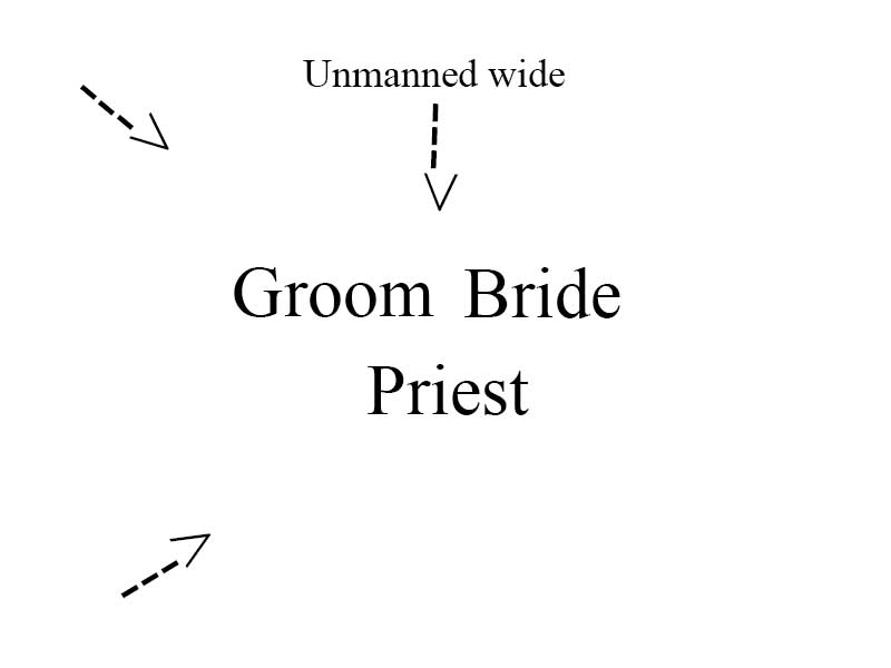

Example 4: Relocating from a groom's first look set-up to double-aisle-camera. Interesting compromise, but: (1) the shuffling time involved in relocating cameras; (2) now you're blocking the aisle for photographers and for people taking communion; (3) you're probably blocking guests' views of the action; (4) some churches have aisles that are too narrow for this configuration anyway.

Option 1 for us...sort of.
We use just 2 cameras. One at the back like you have it for the grooms reaction and then the master wide/med shot throughout. The 2nd camera is crouched down at the front of the aisle (usually a few feet from the groom) on the same side as the master camera but facing up the aisle to get the bride walking down. When she get's most of the way there that camera pulls out to the side about 10 feet to get the "hand off" and when that's done he continues back around to the side and sets up for the close up on groom and then at some point moves quietly all the way around to the other side to get the close up on the bride. With 3 cameras, he wouldn't have to travel as much of course.
If the church has an area behind the altar on the sides where we are allowed to shoot from (that you show on your diagrams) then that camera might move there for portions of the ceremony as well. So one camera moves quietly all around while the other one stays in the center aisle getting the straight on shot mixing up med/mcu/wide shots, playing it safe while the first camera is on the move.
You mentioned if you don't have much "freedom of movement"...well, as you know, that can be tricky if with tight spaces but somehow we've found a way. Actually, the trickiest was a greek orthodox wedding where they went into a completely different room outside of view of anybody for a few moments...we just pulled wide and listened. Not much you can do and the bride/groom totally understood that. Even if our camera op has to quietly go out a door and all the way around (still rolling) to get to the other side of the church that's what we'll do. For the bride walking down the aisle shot, the trick here is being "allowed" to shoot in that center aisle (crouched down to be more inconspicuous) at the start of the Ceremony to get the processional. Most churches out here in SoCal let us do this but there are a few tough ones for sure. The stricter ones I simply have a "talk" with the church coordinator or even the priest and tell them my background and they ease up. And by background, I don't mean as a filmmaker, but as a Catholic church-going, choir-singing, member who appreciates the sanctity of the service (which happens to be true).

Option two, but you want the 3rd cam as unmanned wide at the front on the brides side. This is assuming you can only man one cam or that you are only permitted access to one cam during the ceremony.
In practice the physical characteristics of most churches in the UK make this impossible so its more of a theoretical than a practical discussion.
