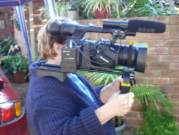

Which receiver are you using?? My Azdens used to come with a shoe mount but I found it rather cumbersome on top of the camera even though the 160 does have 3 threads on the back of the handle. I liked my receivers on the right hand side towards the back so they were out of the way so mine were mounted with a simple rail system under my 130's and two strips of aluminium flatbar under the camera. What I ended up doing in the end (for two receivers and not enough hotshoe spots) was to use two strips of 1" square aluminium tube and just files a cutout in the tube so the receivers popped in.
This was actually all part of my should mount rig for the 130's and keeps the receivers out of the way.
If you want all the construction details of the rig, let me know

I just don't like the receiver sticking up on top of the camera handle/hotshoe ..it seems to get in the way always. On my EA-50's because the shoulder mount slides backwards and the top has two 1/4" inserts I made an aluminium bracket at the back of the cameras and one cam has two receiver mounts and the other has one ..also keeps the profile lower how I like it!
