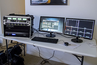

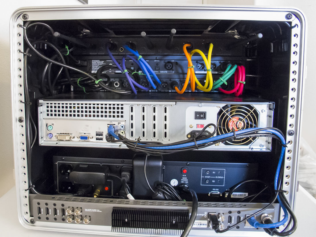

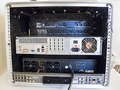

My various cables and connectors that I needed to start wiring everything up arrived on Friday. As a result I was able to do all the cabling for the flypack.
This should have been the final step. At this point everything should be working and I have everything I need. Unfortunately there is one component that is apparently not working. The Behringer SRC2496, the A/D audio converter, is not functioning properly. Some of the buttons on the front are not responding and it is not outputting audio.
An internet search has revealed that this is a hardware issue. Unfortunately it is now too late to return it to the retailer, so I have to try to go through Behringer's warranty repair service. Based on what I've read online, this could potentially take several months.
Obviously this is extremely frustrating. I was hoping to start advertising the system for rental within a few days. Now I have no clue how long it is going to take before I have it all up and running.
On a positive note, everything else is working perfectly. Video switching, audio mixing, and wireless audio system are all functioning beautifully. I just can't combine the audio with the video for recording or live streaming.

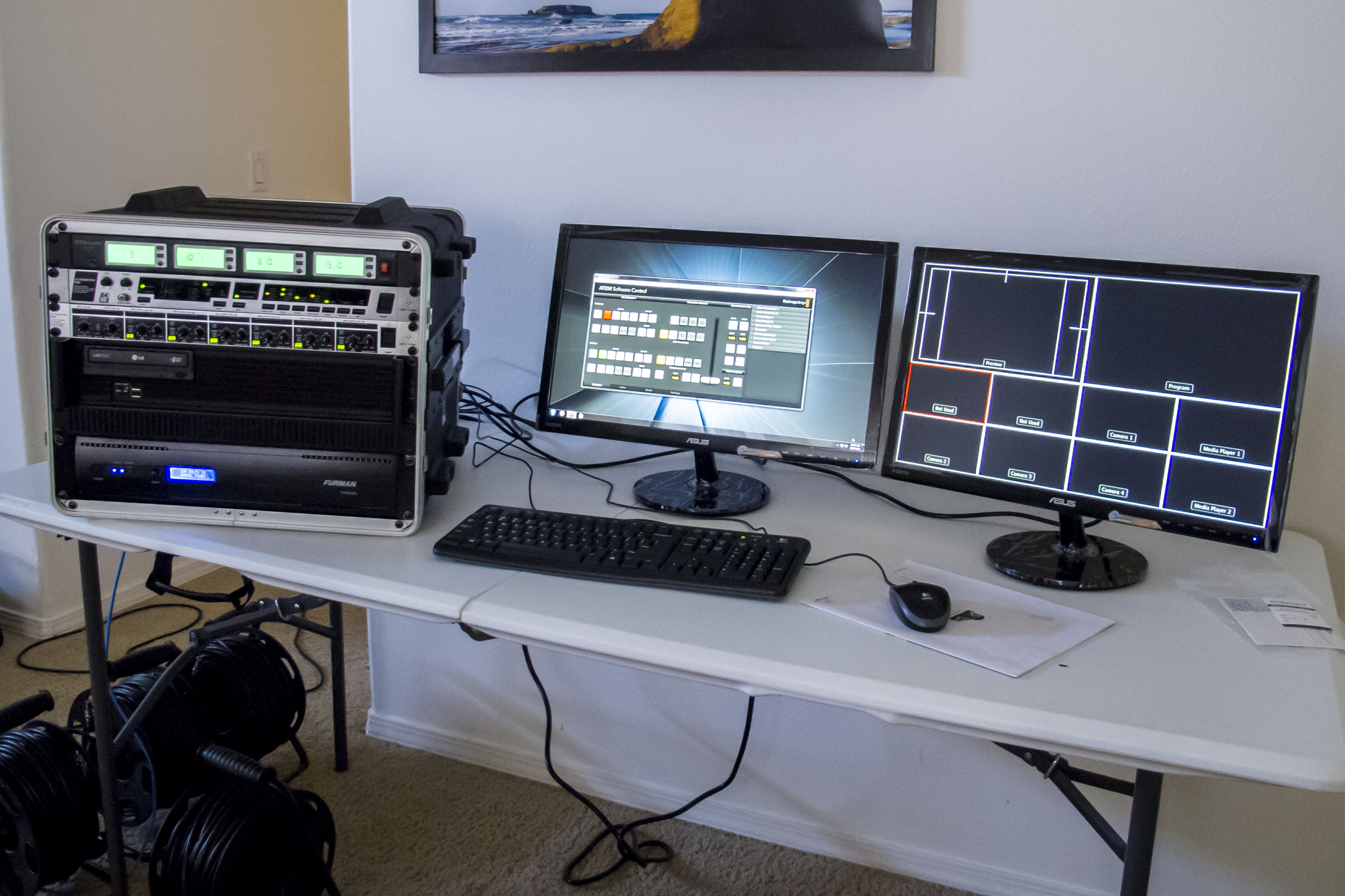

Attached is a picture of the finished flypack showing how it will likely be set up when I am actually using it on gigs. The table is a portable folding table, there are two monitors plus the keyboard and mouse that will all need to be plugged in. This is all run off of the power conditioner with only a single power cord for everything. The cameras will all plugin to the back of the flypack. I can run four wireless mics off of the flypack itself, but I also have two free 1/4" audio inputs for patching in external sources.
