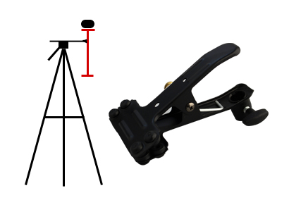

Hey folks, I occasionally come up with hair-brain ideas to try and overcome some awkwardness I face. I sometimes chat it over with people to see if they can spot any flaws that I can't.
I'll outline the issue firstly. Generally speaking I like to be on my glide cam before service and after service inclusive of the coming down and going up the aisle. Now as you all know, theres time lost in taking your camera off and mounting onto tripod. You also have to do some fine tuning when you mount back to 'steadycam'.
Heres my idea -
Creating a short horizontal arm incorporating a mounting plate at one end and a studio clamp at the other. Then using the clamp to hold the shaft (not the handle) of the 'steady cam' during the service.
Panning and tilting will then still be possible (being off center shouldn't create too much of a problem I hope), and the change over is effortless, and the 'steady cam' doesn't need rebalanced.
Crazy? Or Genius?

Might I add - If i had an emergency during the service, such as somebody standing in front of me, or neither of the couple's faces being visible - with ease I could release the clamp and go handheld and take my camera to another position temporarily.

If I understand your concept, Clive, you are talking about cantilevering your sled off the front of a fluid head with a short arm?
If this is the case (and by the way, a simple diagram to illustrate your concept would make it a lot easier to visualize), it would effectively be like having a very front-heavy camera. The fluid head would dive forward and stay there, and it would take a lot of force to tilt back. You could compensate for this with counterweight at the back, and if cleverly done it could be something you already have with you (an accessory bag, batteries etc) so you aren't lugging extra weight. Essentially your arm would be twice as long, with the quick release plate in the middle (if you made the counterweight end longer, you wouldn't need as much ballast attached, but you increase your footprint which is probably not worth it).
Be aware however that tilting forward, the length of the rig will present issues as it will quickly collide with the legs under the head, limiting your tilt significantly.
If this is the desired concept, I would suggest mounting the rig off to the side rather than forward on the head. You'd still need the counterbalance on the other side of course, to keep the sticks from tipping and to reduce strain on the head. Now your tilts will be unobstructed, and the whole thing will pan together so no issues there either. Also, you will be able to keep your body a little closer to the rig itself which may help depending on what monitor you are using. In this scenario, it could be a pretty workable concept. Your head needs to be able to take the weight of the whole shooting match of course, but that's easy enough to calculate. Is this barking up the right tree?

Hi Charles, thanks for taking the time to get your head around my idea. You are correct, in that my plan was to have the clamp at 90 degrees to the tilt action.
I would also be using a fairly wide angle on this particular camera, and it would be my 'B' angle which would be unmanned. Panning and tilting ability is therefore not overly vital.
My DSLR will be set up and shooting as I arrive on the glidecam, then once I have the gllidecam clamped in, I move over to the DSLR rig where I will remain throughout the service.
Now I just need to find a clamp I can trust and figure out a way to fashion it all together!
