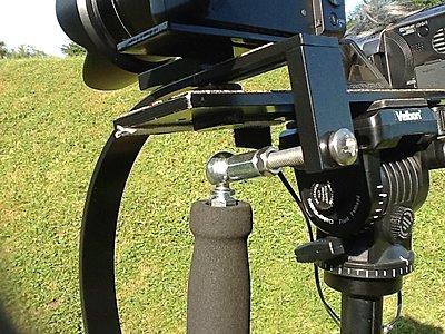

My whole wedding approach is lightweight equipment, and discrete filming, so everything needs to be light and quick to set up as I am usually solo. I bought the cheap Glide Gear SYL 3000 to play around with and the first thing that I found was that the plastic gimbal mount was very poor and kept sticking. A bit of research came up with the fact that it is basically a gas strut ball joint as used on cars, so I managed to order a stainless steel one from a bearing supplier for £12 which was an exact fit, so just unscrewed the plastic one and replaced it with the stainless steel joint. The transformation was impressive, the only minor downside being that the max angle of tilt is less, but I don't see tha being a problem.

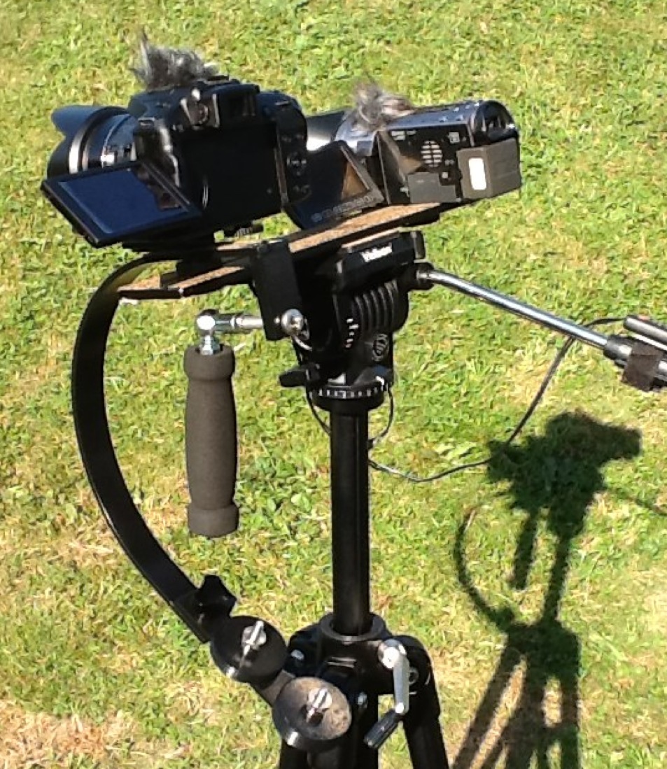

I have balanced it for the Lumix, using the off centre mount that came with the stabiliser and after marking all the settings, can set it up in about 3 mins out of the case. I use a twin camera plate on my tripod and found that I can slide the balanced camera and stabiliser over the end of the plate, with one standard thread screw holding it in place. It takes about 5 seconds to attach or remove and can be used on the tripod next to the small Panasonic video cam for narrow and wide angle views, or slipped off the tripod to leave the Panasonic capturing a wide angle while I follow the action with the steadycam.
If the two pics from the iPad upload, they show the glide gear stabiliser with the Lumix and the SD700 both on the tripod and a close up of the new gimbal and the simple mount.

Can't seem to attach the second pic in the first post so here it is

You seem to have wisely got around that with the stainless replacement. Have you lubricated the joint?

Steve - it's actually extremely light, as is the Lumix, but I wondered if you missed my point that the stabiliser is actually attached to my double camera tripod mount in the picture. The curved bit, handle and camera are just attached with one screw thread for quick release and the rest is the tripod and other small Panasonic video camera.

Tim- the SS replacement for the ball and socket is a big improvement, and I lubricated it with a silicone lubricant to reduce friction. Being stainless though, I may try an oil based lubricant to see how that compares. The ball is easily removed for access as it has a removeable clip.

How do you balance left to right? Can the camera be offset or do you use that weight on the bottomside to direct it to the left or right get the camera level?

There is an offset bracket supplied with the kit for mounting the camera if needed, and there is a pivoted bracket for the weights at the bottom, which can be pivoted left or right for balance. I've marked the adjustment and mounting points so that I can balance very quickly. Once balanced, the steadycam is either handheld or tripod mounted for quick release.
