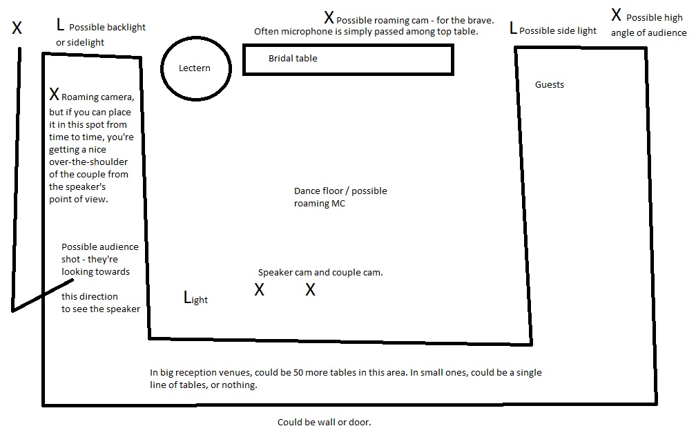

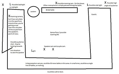

Hey Peter, one thing you could think about is (a) setting up your speaker cam next to the couple cam, so you can operate both at once; (b) putting a different lens on the couple cam... In DSLR terms, maybe a 28-300. You can then go tight for couple reactions, and pull out for entire bridal table.
Here's my normal setup. Apologies for the mess. Drawing skills, I have none.
Normally just three cameras, but two operators. I ordinarily use: two x 70-200 on the speaker and couple cam; a 100-400 on the roaming cam. Job of roaming cam is: alternative angle of speaker and cutaways of anything around the room -- parents being mentioned, someone clapping or laughing, page girl falling over, etc. If it's possible for the roaming cam to occasionally get over-the-shoulder shots of speaker and couple, I find they generally look pretty amazing.

Adrian, in all the years I've been filming, I've only a couple of times had a layout like that. Normally where you have the dance floor is full of tables and there's no lectern either. Makes discussing camera positioning from country to country interesting…. doesn't it ?

Thanks Adrian - over here however that layout hardly ever occurs - I've seen a similar table layout but never a lecturn. Usually speakers just stand up from where they were sat on the top table. Complications arise though when the speakers are dotted around the room which I've had a few times!
