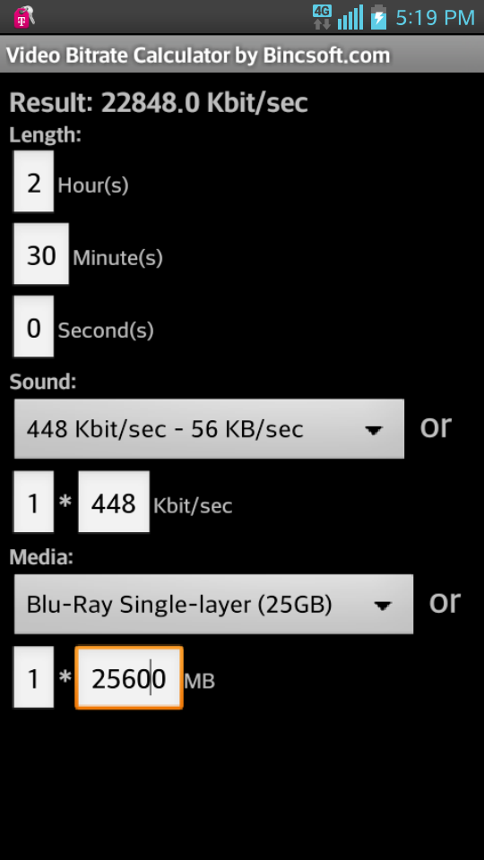

My phone app is saying 2hrs 30mins at 22mbs compression. Image attached.

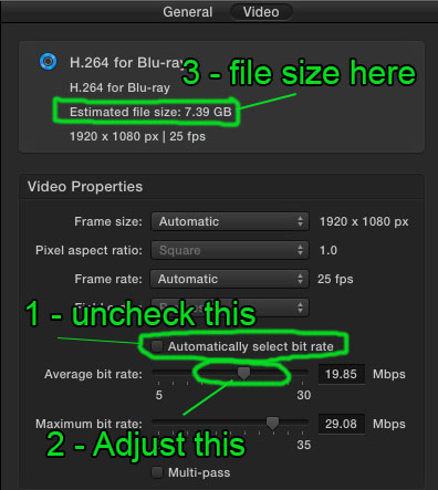

Originally Posted by Scott Brooks View Post
I edit with FCPX and right now I'm shooting at 1080 60i with a Sony ax2000 and Canon xa10. I'm seriously considering getting rid of the Sony and going with an xa20 (even though I don't like the menu system).
I can use the "share" feature in FCPX to go to h.264 within the system, but if I need to change settings then I think I have to take it to Compressor.
Making the required presets in compressor and having them available in FCPX is trivial, and hopefully you know that you can easily set the bit rate and easily see the file size it's going to produce.
BTW - I always export a ProRes file from FCPX first as my master file and 'then' retarget that to what ever I need in other codecs in Compressor or Media Encoder. YMMV.
