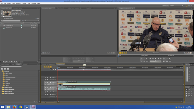

So does the HD files resize to the DVD fine?
I always used to the HD files into a SD Sequence in premiere pro and then export again, as to resize a 1080 or 720 to SD it always seemed to add bars at the side. (see my pic below)

That's because the pixel aspect ratio of SD and HD don't match. when you export from Premiere Pro add a top and bottom margin (crop) within the export dialog that add up to exactly 26 pixels, i.e. 13 top and bottom (progressive) or 12 + 14 (for interlaced). Then the bars will be gone. **Note I said add them top and bottom and not the sides ;) If you add them to the sides your problem would be even worse.
Personally, I've found the CUDA resize during export to be better (less aliasing) than adding an HD sequence on to an SD sequence but you may have different results. If you don't have a CUDA card then it really doesn't make much difference.
