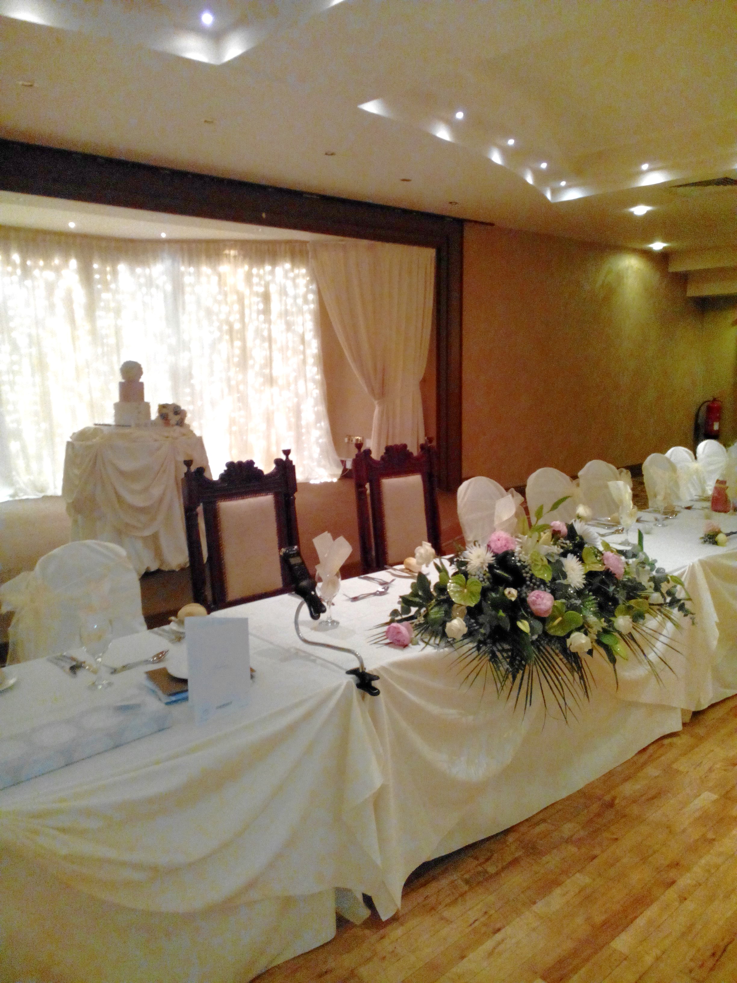

As for the friction arm, I bought one of these and was pleasantly surprised.
http://www.amazon.co.uk/gp/product/B...?ie=UTF8&psc=1
Here it is holding the Tascam - but I may go for tabletop tripods instead. These bendable clamps are useful though for sloped lecterns in churches though.

I prefer a lower profile means of support than the one you linked to so that its not so prominent in the foreground. A table top tripod would have worked just as well in the photo you posted. I also aim to hide the equipment behind flowers or by moving wine bottles menus etc on the table. But thats probably just me as a photographer - I absolutely hate it when a big piece of equipment grabs the foreground!
If there is no hiding place e.g. on a lectern I may use a lav secured in place using this heavy duty black tack with the actual recorder hidden out of sight
Black Tack 19mm x 1m, high strength adhesive putty for: Amazon.co.uk: Electronics
The friction arms are strong enough to hold a handy cam as well - giving much more flexibility to b-cam placement. The crab clamps are quite strong but sometimes switching out to to a Manfrotto superclamp can be more secure.

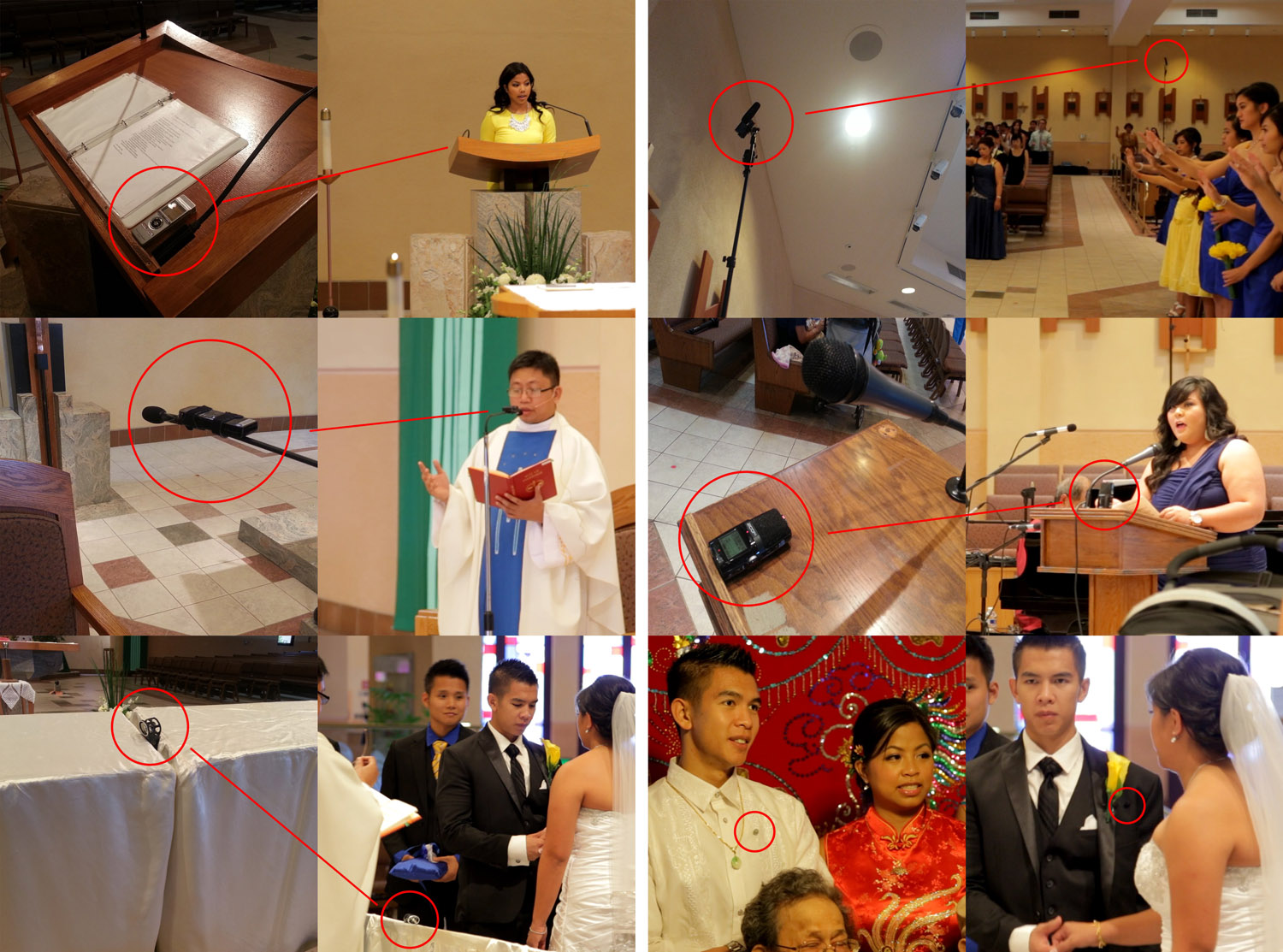

I dont do much these attaching the voice recorded on handheld mic. But many times, if there's a mic stand, I will Velcro the h1 on mic stand which gives great result too.
Here's a picture showing how I place voice recorder everywhere at a catholic wedding
For lav Mic, I use rode PINMIC Which is very discrete. No visible cord.
I've tried laying them directly on lecterns as in the photo but found that they can pick up a lot of handling noise if the reader starts moving the reading material around or touches or grips the lectern. The white version of the Zoom H1 works even better than the black when hidden close to a white clothed table edge as in the other photo; I've also used a white lav in that scenario so that only the white tip of the lav is visible.
A monopod with its feet extended and collapsed to about 3ft high can also be a small discreet alternative to a lightstand for holding a recorder - its low profile feet mean it can be placed that much closer to a table edge or in very confined spaces whilst remaining low visibility.
