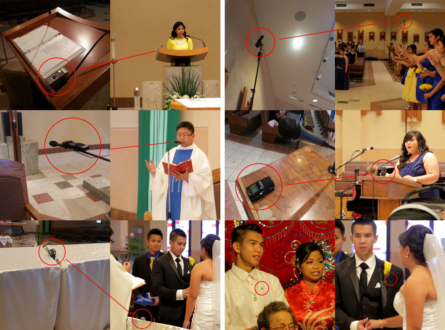

I put voice recorders everywhere :)
lol, love the squished H1!
