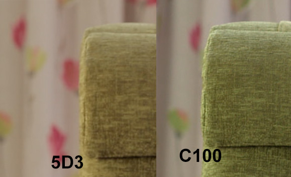

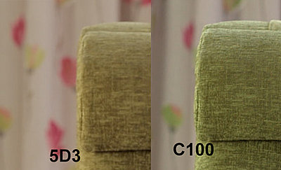

But, there is a major problem with getting a C100 that you need to be aware of, and it's not really the fault of the XF100 or the 5D3 as such, but the C100 is just so much better in terms of dynamic range and sharpness that it makes you truly dislike the total lack of detail in the DSLR images, detail you perhaps didn't realise was missing.
We're not talking DOF here, but how little detail they actually resolve (resolution), how poor the dynamic range is, how badly they crush the blacks (even with flat settings) and how easily they posterise certain colours, especially in grading.
In many cases the XF100 holds better details (resolution) than the DSLRs, albeit with slightly more noise, and it's easier to match those shots to the C100 than it is from the DSLR.
It's easy to get misdirected by the DOF issue and not realise that so much detail is being lost, but lost it certainly is. You only have to shoot some text on the side of a box from across the room and compare.
Of course once you're in to low light the XF100 can't hold a candle to the DSLRs or the C100, so it's all a bit of a compromise and a case of picking the right tool for the job.
The codec from the XF100 (4:2:2 50mbit) holds up much better to pushing and pulling than the DSLRs do, but you have to be prepared to do a LOT of pushing and pulling to even come close to the C100, or you have to dumb down the C100 so much to make it match the DSLRs. Your choice. the C100 internal codec holds up amazingly well for 24mbit AVCHD, so much so that I'm really not using the Atomos Ninja as much as I thought I would.
If you try to match shots from DSLR to the C100 from relatively close angles (e.g. one of you was close and the other wide) then you're going to cringe at least as much as mixing DSLR with shallow DOF and XF100 with the whole world in focus. The colours are different, the details are different, you may as well have been shooting with totally different brands.
You'll need to be at significantly different angles to allow the eye chance to accept the different pictures and you're likely to spend a lot more time in grading to match colours.
Unfortunately I can't upload any complete shots from yesterday's shoot because it's all under NDA until it's released, but let me at least show one crop example.
• The chair was bright green and the green from the C100 is just about perfect while the 5D3 has way too much yellow in it.
• Both were set to the same kelvin temperature with no other custom white balance offsets.
• Both focused on the material of the chair (this was a test shot for lighting prior to the talent arriving),
and for the avoidance of doubt,
• The 5D3 had been manually focused using the 10x zoom function on the LCD and it was visually tack sharp, but alas not so sharp once it's been de-bayered and recorded/encoded. < sigh >.
Seriously, if you don't want to be unhappy with both your other cameras, steer clear of the C100. Get yourself a matching DSLR and be happy. Spend the extra money on glass, especially glass that you can carry forward as new bodies come out.
Once you start shooting the C100 you'll wish you had two (or more). I'm seriously thinking my 5D3s have got to go because it's causing too much work to make them match.

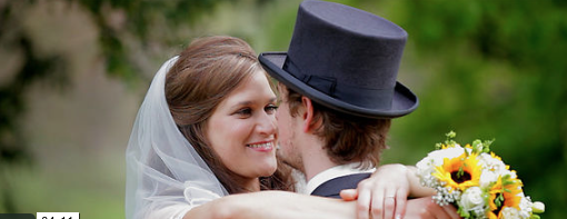

Thanks for posting the video.
I do agree in that reception light the XF100 is going to suck big time and we'd have lights on for sure if we were shooting there with only XF100s. People really don't mind as much as you'd think they would as long as you can get the lights fairly high and not directly in their faces.
In your situation I think I'd be going for another 6D so you have matching cameras and then get some faster glass.
The 50 f1.8 is nice and cheap, but you get what you pay for. The focus ring is nasty and even worse there is quite a big of barrel distortion there too. We had one and sold it within a week having compared it to both the 24-105 @ 50mm and also a 50mm f1.4. While still not perfect, the 1.4 is a much better lens.
A 24mm f1.4 or 35mm f1.4 would be ideal for wider shots in low light receptions like this one, but the other lens you should really be looking to acquire is the 70-200 f2.8. You don't need to spend the money on the IS version unless you're planning on using it on a monopod. On a tripod (recommended) you'll be turning the IS off all the time anyway. This will allow you to get those long shots on the 6D while still being able to open up to f2.8 in lower light (be careful of the shallow DOF at 200mm f2.8!!!). While the f4 version is cheaper/smaller/lighter, we found we needed that extra stop from time to time. Also, put a vary-ND on the front of the 70-200 f2.8 outside and you can get some nicely isolated shots while still being quite a distance form the couple (see below).
If you don't mind manually focusing then the Samyang 24/35/85 are great lenses for the price and you can get all three for the price of the Canon 24 1.4. We use all three focal lengths quite a lot at weddings. Punching in the 10x zoom (I assume the 6D can do this via the set button like the 5D3?) makes focusing much easier, though having AF is nice when you need it.
