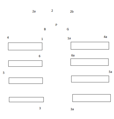

Hi Jeff,
This is how I think about processional...
Camera position 3 -- safety wide. To be a proper safety, make it wide enough to include all bridesmaids and groomsmen. Alternate plan is to frame it tighter, just for the middle of the aisle, and then readjust later. If it's only you, then this one will be unmanned on entry.
Some videographers man this camera, and leave the camera at the front unmanned (either pointing up the aisle, or pointing towards where the couple end up). This means you can pan to follow the bridesmaids if they're coming in from the side, and that you're in a perfect position to readjust the camera to centre aisle later. The trade off is that you won't see the bride's face as she walks down the aisle (unless your other camera gets it). You might get a great over-the-shoulder of the groom's reaction though.
Camera position 3a -- an alternative... think about "crossing the line" and where your other camera will be placed. Think about from which side the girls will walk in (left, right, or from straight back).
Note that, if you like, you can reposition both these cameras to centre aisle during the ceremony, but you'll have to run around and move them before communion / recessional afterwards.
I prefer to leave aisle free whenever possible -- photographers appreciate it.
Camera position 2 -- the problems with this position are that you'll be all over your wide shot, you'll pee off any photographer trying to get a wide shot, many priests won't let you stand here anyway, and the final catch -- you might get zero groom reaction. But if everyone is okay with this shot, then it's a great angle to cover entry, you usually do see something of the groom's face, and some ceremonies have the couple faced the opposite direction for the most part anyway (Catholic masses are often like this; Greek, Armenian ceremonies very often like this; even Jehovah's Witness sometimes like this).
Camera position 2a or 2b -- more discreet version of 2.
Camera position 1 -- where, in practice, most people stand. To remove yourself, or be less distracting, for the wide shot, you might crouch with monopod or shoulder mount to cover girls' entry. If you're game, you can even spin around from time to time to get some sort of reaction from groom. Covering the handover/unveiling can be messy, though -- at some point you'll have to scamper out of the way at the last minute, and quickly set up for it.
If your wide angle is going to be unmanned for most of the ceremony, this is also a good place to capture priest/readers from (but more to the side, to be more discreet).
I usually start at 1a rather than 1, so that I wind up on the side favouring the bride. But 1a doesn't give you an optimum shot of the groom's first look. Sometimes he turns side on, and all you see is back of head.
Incidentally, depending on layout, both 1 and 1a might be too close for a 70-200.
Camera positions 4 and 4a -- the basic problem with 4, although it's more discreet, is that when everyone stands up you'll probably get blocked.
Camera positions 5 and 5a -- risky -- high chance of being blocked. But maybe you can pick up interesting through-the-crowd shots of the bride entering, for about a second. Can be used with slider or steadicam. If you've only got two cameras, and you start your manned camera in this position, obviously you're going to have to run around to the front after you get a few shots to cover the handover... unless you've got a long enough lens / enough people not blocking you, to see from that angle... and even then it's not optimum.
Camera positions 6 and 6a -- variation of 1 and 1a. Depending on layout of the church, you might want to start standing the pews. I don't like doing this, but some people do it all the time. There might well not be enough room to have a tripod in there, so it's monopod or shoulder-mount... or tripod with legs folder together. But one big advantage of this position is that you can readily readjust to centre aisle after she walks past to cover the rest of it. If you're game, you might even try having both wide cam and secondary cam with you in this position, and readjust both of them after processional.

Hey Jeff,
Lens choice -- just depends on the layout of the church. Best to go to the rehearsal and check it out.
Which camera to operate if you have two shooters -- definitely the front camera. The back camera (3, 3a) can be left unmanned -- it's mainly there as a safety.
Another thought: if you have two shooters, the possible positions change. For instance, instead of a safety wide, you could have one shooter at camera position 4 getting a clean groom's first look, and then covering the handover, while you're at position 1a (in this case it's crossing the line, but, in the scheme of things, doesn't matter for weddings). But if the second shooter is inexperienced, an unmanned wide camera would probably be better than relying on them to get shots... you risk having nothing to cut away to while you're adjusting your camera.
And one more thought: a position I didn't mention is the roaming steadicam -- following the girls in at least to when they start to enter the aisle proper. But, frankly, I don't think you should worry about this shot... It's eye candy. I think the reactions of bride and groom are the most important.
Keeping out of shot... Well, alternatives are:
1. Frame the camera at position 3, 3a so it's getting a mid-shot on the groom, and you're crouched out of frame under the shot. The problem with crouching on a monopod is that at the last minute you'll need to awkwardly scamper out of the way to get the handover.
2. Depending on church layout, frame camera 3,3a so that it's a close-up on groom, giving you plenty of movement (very risky though -- grooms often don't stay in the same spot, and it's tricky to readjust at the last minute before the action starts).
3. Frame the camera at position 3, 3a so it's getting a wide of entire bridal party and you're less conspicuous in the shot. Wear black clothes. Trust me -- no one will care except you. The photographer is going to be all over the shot anyway (either walking backwards in the aisle, in front of the bride, snapping away, or standing/crouching at position 1 to match you).
4. Get the shot, standing up with a tripod, and don't worry about being in frame. Plenty of videographers will do this.
5. Do something else, like start at position 4a and hold the camera up really high to cover above the crowd to get bride and bridesmaids entering, then lower it to cover the hand-off. I find this intrusive, and you probably won't get a good look at bride's reaction, but it's an option.
By the way, check out this video of mine... Skip ahead to 1:06. You can see me in the wide shots as the bride enters (not ideal, but at least I got the shot), and you can see where the photographer stands, which is also where a lot of videographers do like to stand. You can also see the overexposure problem you might well face as you point straight down the aisle...

Height could be your friend. In this case, you could shoot from the sides, instead of the top of the aisle, but still see her. Ie tall tripod, or monopod extended, or simply holding the camera up if you have to (maybe attached to a steadicam).
Alternatives... Could be behind the priest, like in the notorious video where the priest turns and yells at the photographer and videographer to move. Could push one set of parents out of the way in the first row of chairs, and shoot from there. Or, if all else fails, you could stick an unmanned camera (maybe even a GoPro) somewhere strategic to cover the entry.
