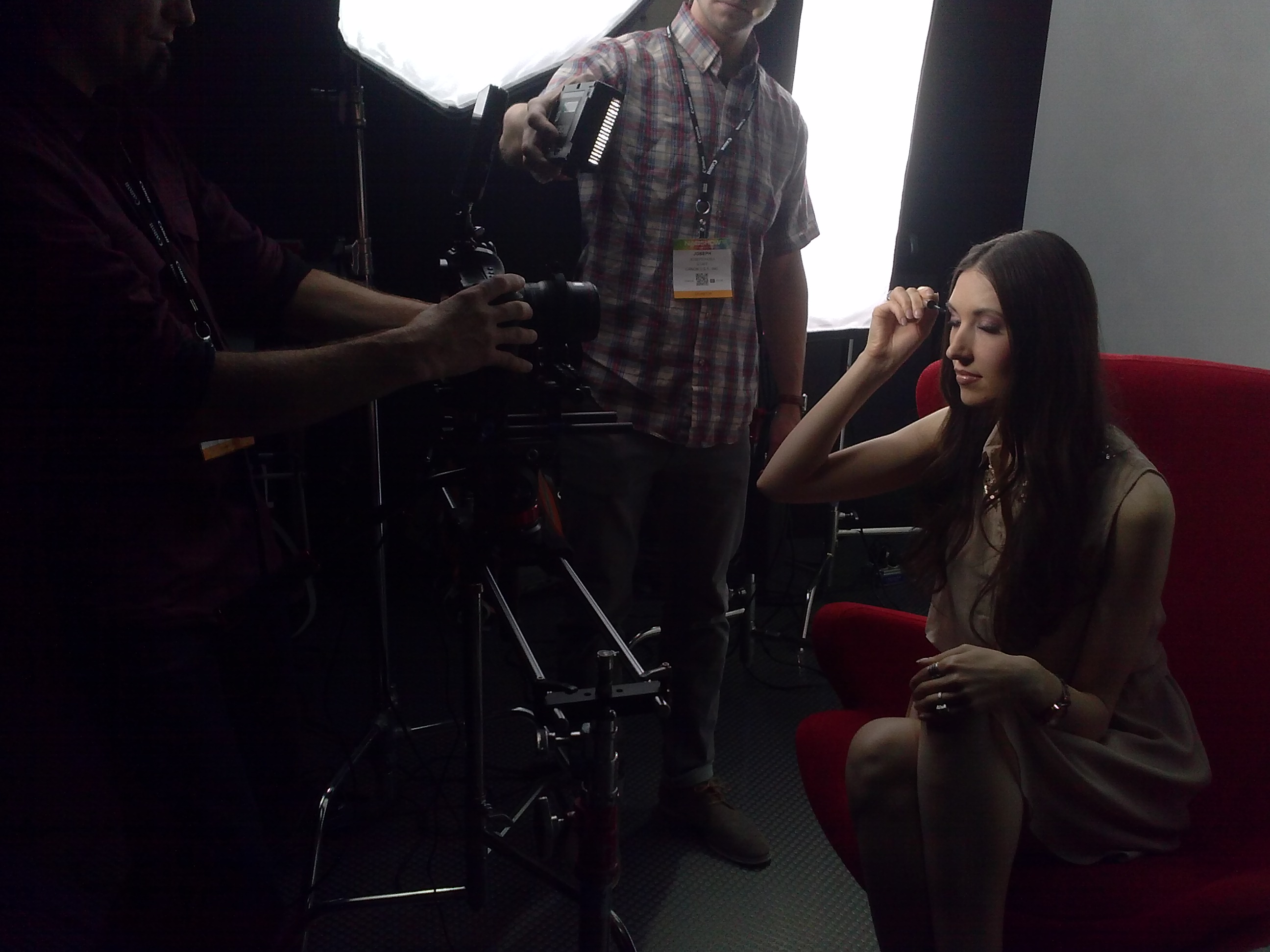

Did anyone see the Canon booth at NAB? This photographer was shooting video with a 1DC, 4K raw. He had a printer, and was printing out frame grab closeups of the model's eyelashes blown up 16x20 inches, then passed the prints around for us to see. It was sharp sharp sharp! He had a 100mm cine prime. You really had to be there to believe the sharpness...no artifacts or blocking were visible. Mind absolutely blown because it was from video!
It looks like a well lit portrait session where the model is posing & keeping still. Even if it wasn't 4K the stills grabbed from the video would still look good. Contrast this with grabbing stills from a video when the subject is moving.
I shot several weddings with a C300 & while sometimes you could pull a nice still (generally when they were posing for the photographer) the number of usable still images was discouragingly small.

It looks like a well lit portrait session where the model is posing & keeping still. Contrast this with grabbing stills from a video when the subject is moving.
It was a well lit scene, and very interestingly, there WAS movement in the shots. Camera was on a slider, and he was constantly sliding back and forth while the model was putting on mascara. He put the footage on a FC 4K timeline, then scrubbed frame by frame until he got the composition he wanted, then printed it. I missed the part about his shutter speed, I'm assuming it had to be pretty fast in order to freeze any motion blur. In retrospect, he must have been at least f8 because everything in the frame was "holy cow" sharp. Below is an older video and article I just found. Prior to that demo at NAB, I've always believed (like everyone else here) that print quality from video was mediocre. Times have changed!
