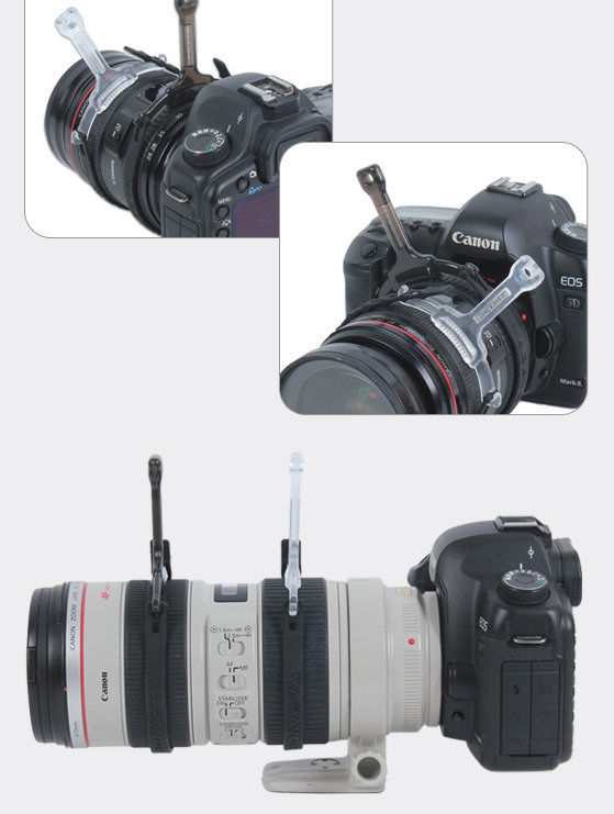

Just for interest I found these on eBay. Not too bad a price at $20 for a pair but I wonder if the rubber will eventually perish and become useless.
Any idea how good these will work??
Chris
