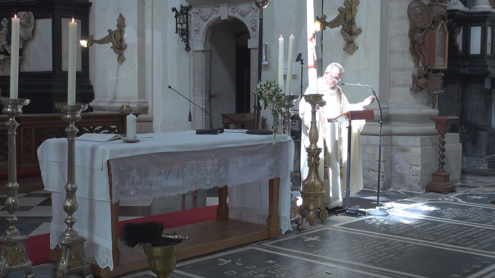

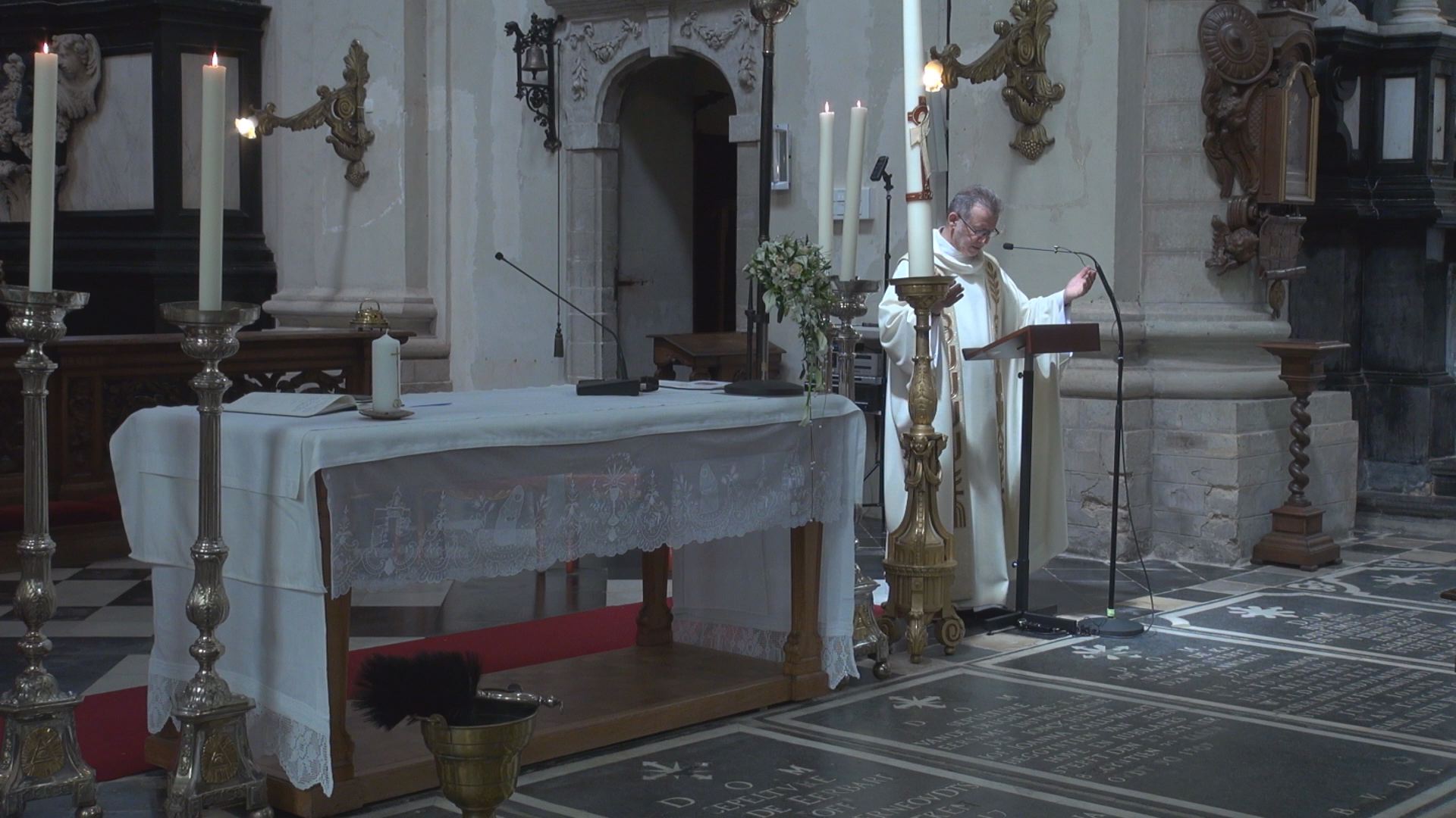

I am editing a wedding now where I had to deal with some extreme differences in light contrast, there was one beam of sunlight coming through a window that was shining like a spotlight on the lectern where the priest was standing, to make matters much worse, it was a partially cloudy day and the sun would disappear and appear constantly, at first I tried to compensate by adjusting exposure but quickly found out this was impossible to do so I just underexposed my unmanned camera a bit and left it at that so I could adjust in post where necessary.
I was lucky the rest of the family and friends used the lectern on the left side of the altar where I didn't have this problem, on such a occasion a 20 stop DR camera would come in handy :)
On the pictures below you can see how it looked when there was no sun and when there was, I think the priest choose that spot for a reason, as if God was shining a light on him :)
shooting extreme highlight differences in a church-no-sun.jpg   shooting extreme highlight differences in a church-sun.jpg

The only way to really overcome it is a really tight shot from one camera on that area and then make sure all the others exclude that area. Not easy!
Actually I started off with a close up zoomed all the way in but the contrasts in the priests face looked real ugly, the sun was also playing tricks with me because the light intensity was constantly changing because of the passing clouds, I tried to adjust exposure manually but couldn't keep up and had to switch to auto but then eventually zoomed out all the way and just let him overexpose at those moments the sun would shine at it's fullest.
If all the family and friends would have used that lectern as well that would have been a small disaster because all readers in the entire ceremony would either over- or underexposed with nasty clipping of the highlights. It's the first time I have experienced it this bad.
