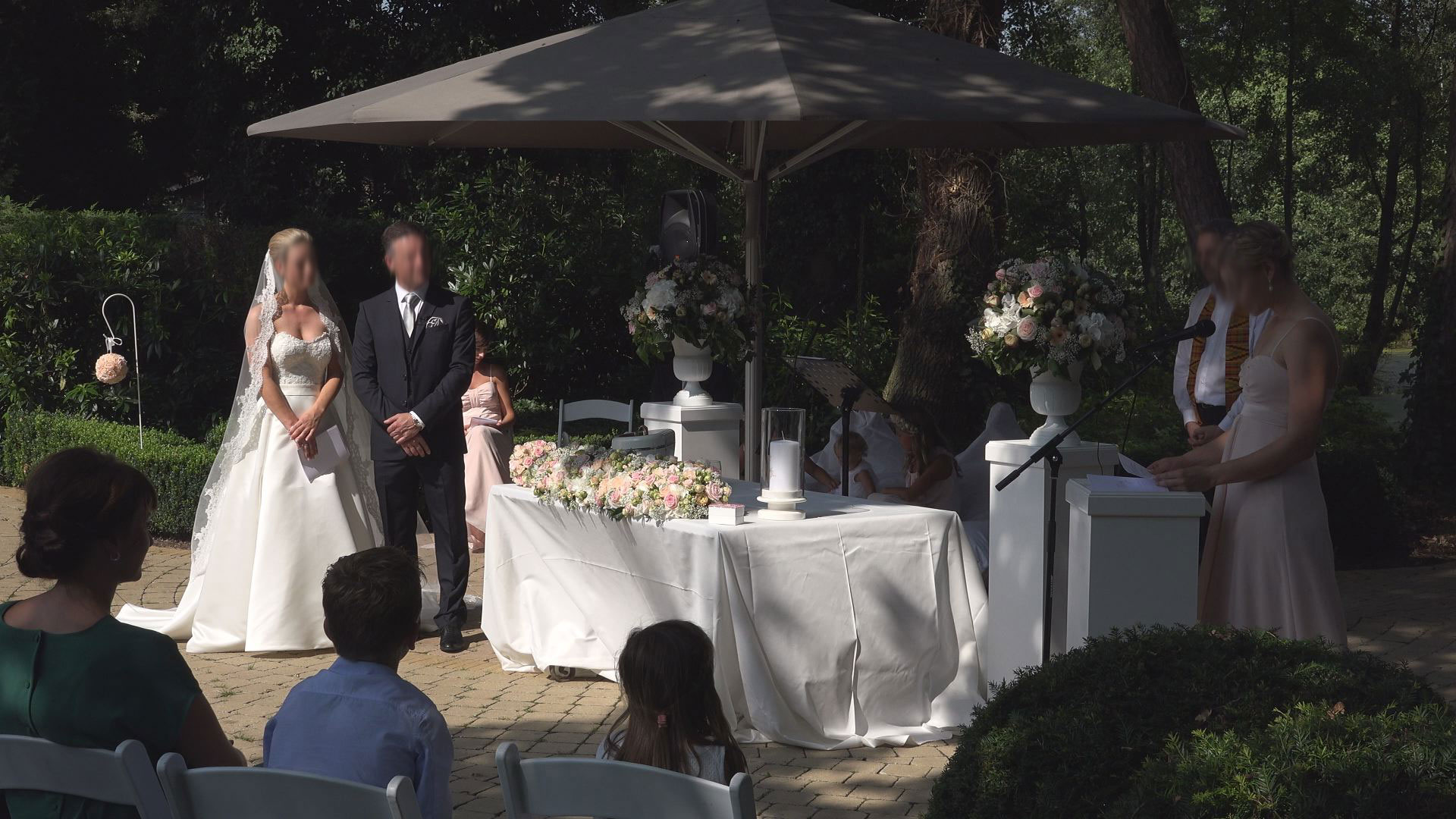

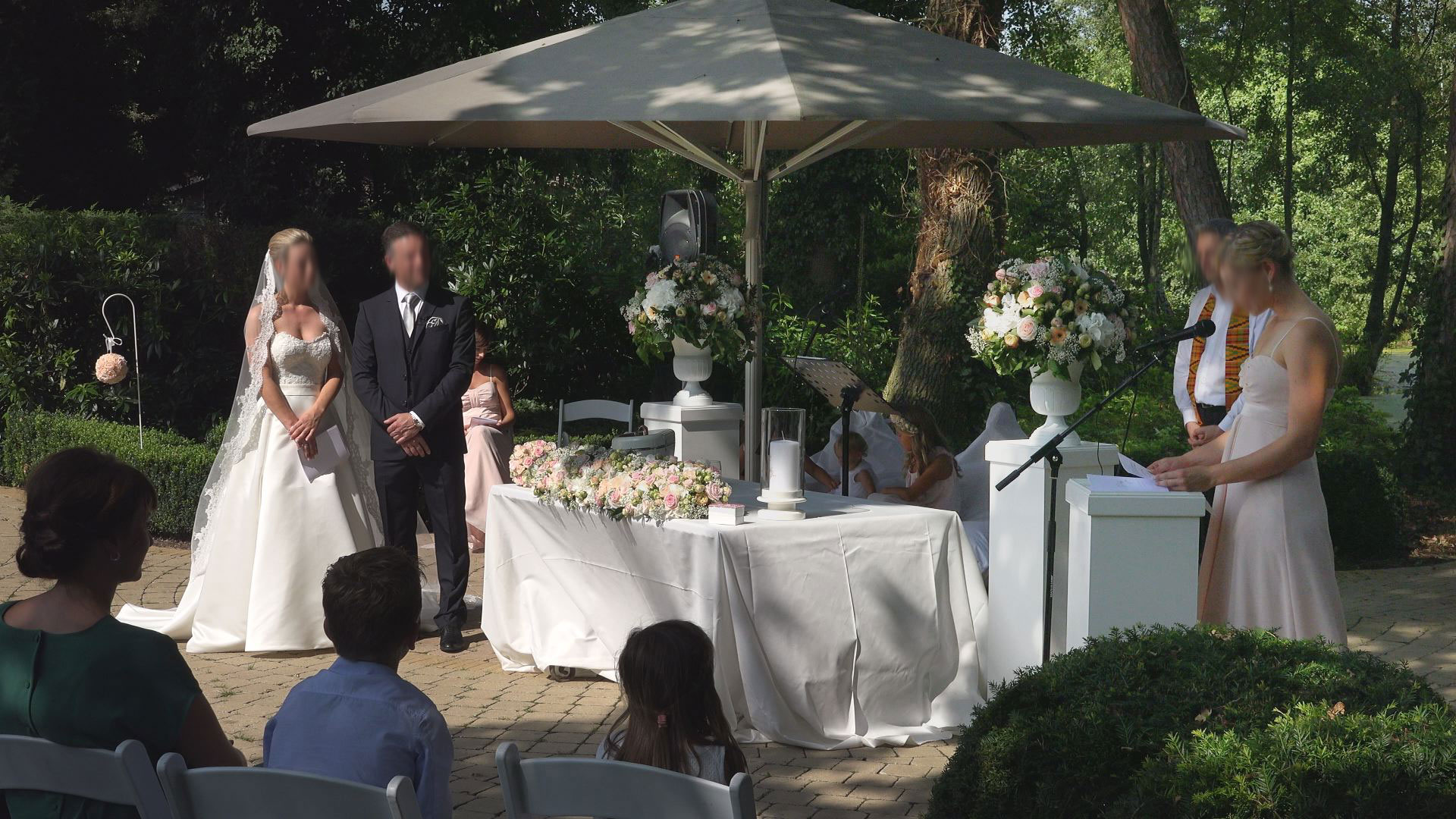

I have just been looking at some footage I shot yesterday and I had to shoot some very high contrast scene, the bride and groom where in full sunlight and the priest and readers in full shadow. Probably most edius users already know this but in Edius you can apply a mask and just apply a effect to a part of the image, in my case the unnderexposed part.
I exposed to the brides dress when I was shooting this so her dress wouldn't clip and in post I copied the clip twice on top of the original, applied a screen overlay on both and used a mask to only apply the effect on the underexposed part, then I softened the corner to smooth the transition. This is just a rough correction and needs some fine adjusting but not to bad if I have to say so myself. :) Render time will be pretty long but it's worth the time to process. This only works well if you have a locked camera on a tripod that doesn't move.
(the faces in the image are blurred as I don't have permission to post online.)
How to give your camera some extra stops of DR-before.jpg   How to give your camera some extra stops of DR-after.jpg
