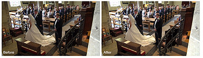

Chris I use Premiere Pro and only make a minor adjustment with the fast colour corrector - I normally increase the input black level from 0 to 5.0 (sounds a lot but it's not really) and the input mid level from 1.0 to 1.1 I also increase the saturation from 100 to 110/120 depending on the scene. Sometimes I will adjust the input white level but that entirely depends on the scene. I also add 5% sharpen.
My main camera is a Sony EA50 and I used to use Panasonic TM900 cameras as well but I had a lot of trouble matching them up - the CX730 footage requires just this little tweak for me
I have to admit to leaving the WB to auto a lot of the time - the CX730 does a damn good job :)
This is from yesterday's wedding
