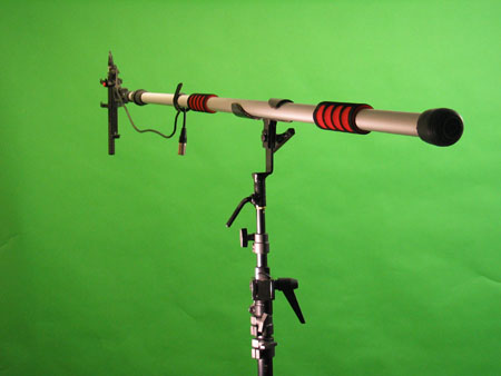

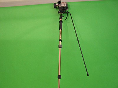

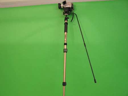

Hi Chris...I haven't done any filming for quite a while...working post-production on my project...but knowing your home build bent, thought I would just raise a cheap alternative to the monopod idea.
Bunnings has a really excellent window cleaning brush on a very sturdy extending aluminium pole...which is in two parts...one sliding inside the other. I think I paid about $NZ28 for it. Ditch the brush, fit a screw to take a tripod head on the top...I just drilled and tapped a bolt into the plastic part already there, put a rubber table leg foot on the bottom, and you have an excellent pole that will get as high as you would want. I've also made up some extension handles to control the head if I want to. Need to drill a hole in the foot to allow air in and out of the pole when extending and retracting, otherwise the suction is too strong...the pole is air tight...
I've attached a photo of the pole being used as a mic boom, so it is multipurpose...and also one of the long controller arm (on regular monopod)...this may trigger some design ideas...
