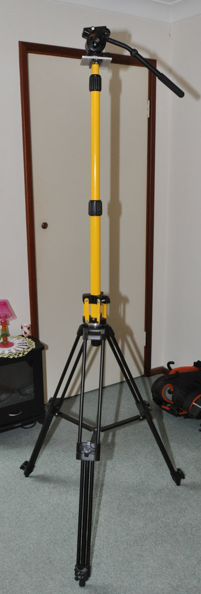

Hi Guys
Just thought I would share my eventual tripod extender mod to enable be to get over the top of guests and photogs when I am blocked solid.
What I did was split a pan/tilt head from the bowl fitting and graft a worklight stand in between the two. With the tripod legs at half height I can get the head to easily touch the ceiling and because the bottom end of the telescopic workstand bit has the bowl top fitting bit on it verticals are easy to achieve if the surface is not level.
Ideally I would have liked an aluminium telescopic bit not steel but this is pretty darn sturdy and has advantages (like levelling) that a big light stand doesn't have.
I have a little aluminium single step ladder which allows me to easily get up to the camera when I need to.
Chris

Thanks Pete
I actually build quite a lot of rigs and also do tutorials for them as well. It's fun to wander around the aisles at the hardware store and think "Wow..I could use that with my camera! "
Always been a bit of a DIY freak and if I cannot find what I want I figure I can make it. Cost of the extension was a cool $00.00 !!! I had the stand in my studio doing nothing really and it was getting in the way. It originally was the stand for two 500W halogen lights that I used for video a long while ago!!
The rig actually works better than expected and I can drop the tripod down so all the legs are closed and the height drops to around 4' something... extend the tripod legs just with the first double tubes out and extend just one yellow tube section and it's close to about 6'6" ... extend the 2nd tube and it touches the ceiling ...if needed I could also extend the second set of tripod legs but that would have to be outside and my little single step ladder would be too low so I won't use that one.
What I really need now is a stand with around 40mm tubes that I can rip to pieces but I need it in aluminium!!!
Chris

Re: Tripod Extender - My eventual DIY solution
Chris, I can appreciate your delight at an excuse to disappear into the mancave but I'm struggling to understand what you have achieved that would not be as well if not better served by a heavy duty light stand!
Both your rig and a light stand will suffer some instability due to the length of the centre column when extended - thats where a good old-fashioned tripod configuration wins out.
But an air-cushioned light stand would be far easier to handle when setting up and breaking down because the elevation is gentle and gradual. Lowering an undampened rig from above head height is inviting trouble unless you are very careful. Thats why heavy studio lights used by photographers are usually placed on air-cushioned lightstands - its very expensive if you break some of those filaments etc.
You have got some ability to level on an uneven surface though, something that must be improvised with most lightstands even just by putting a sandbag under one foot.
That yellow colour has got to go!!!
Come on folks, lets think of another project for Chris to get his teeth into :- )
Pete
Very nice Chris! looks great for more controlled pans from a very high position though you would need something to stand on. I do prefer a lightstand with a ball head but that only would be suitable to lock the position the camera is facing and let it run unmanned. I agree with Peter on the yellow color :) but sometimes I wished my lightstand was yellow, last week I almost forgot it in church, didn't see it standing in a corner and when I was outside while looking at my tripod trolley I noticed the lightstand was missing, if it would have been yellow I would not have missed it, but otoh if it shows up in the frame of another camera it sticks out like a sore thumb. :)

The stand was yellow and yes it will revert to black of course! I just left it the original yellow so people could see what was added to the original tripod configuration.
Pete? It was far easier to take the male bowl fitting off the panhead than try to leave it on and try to replicate a female bowl at the top of the column. The new column bit can be adjusted to any vertical position with the bowl head.
Thanks Tim ..I'm actually looking for a decent diameter tube set for the telescopic sections so the lower tube needs to be at least 40mm or more otherwise it will be unstable. With the current tubes it's pretty darn stable.
Chris
