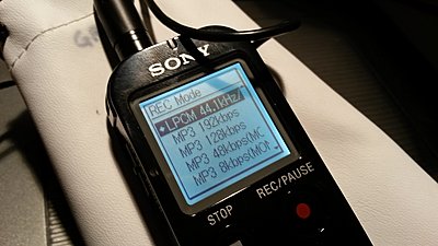

I bought 2 of these to try
Sony ICDUX533B UX Series 4GB Voice Recorder - Black: Amazon.co.uk: Office Products
They are really slim, record WAV as well as mp3 and remember your settings when you change batteries - my old Olympus WM311 recorders used to rest themselves at each battery change that was a small but annoying pain
Pete

Do these definitely record wav files, as a couple of reviews say that it records mp3 only. The spec on the link says records in mp3 and plays back mp3, wmv and wav files.

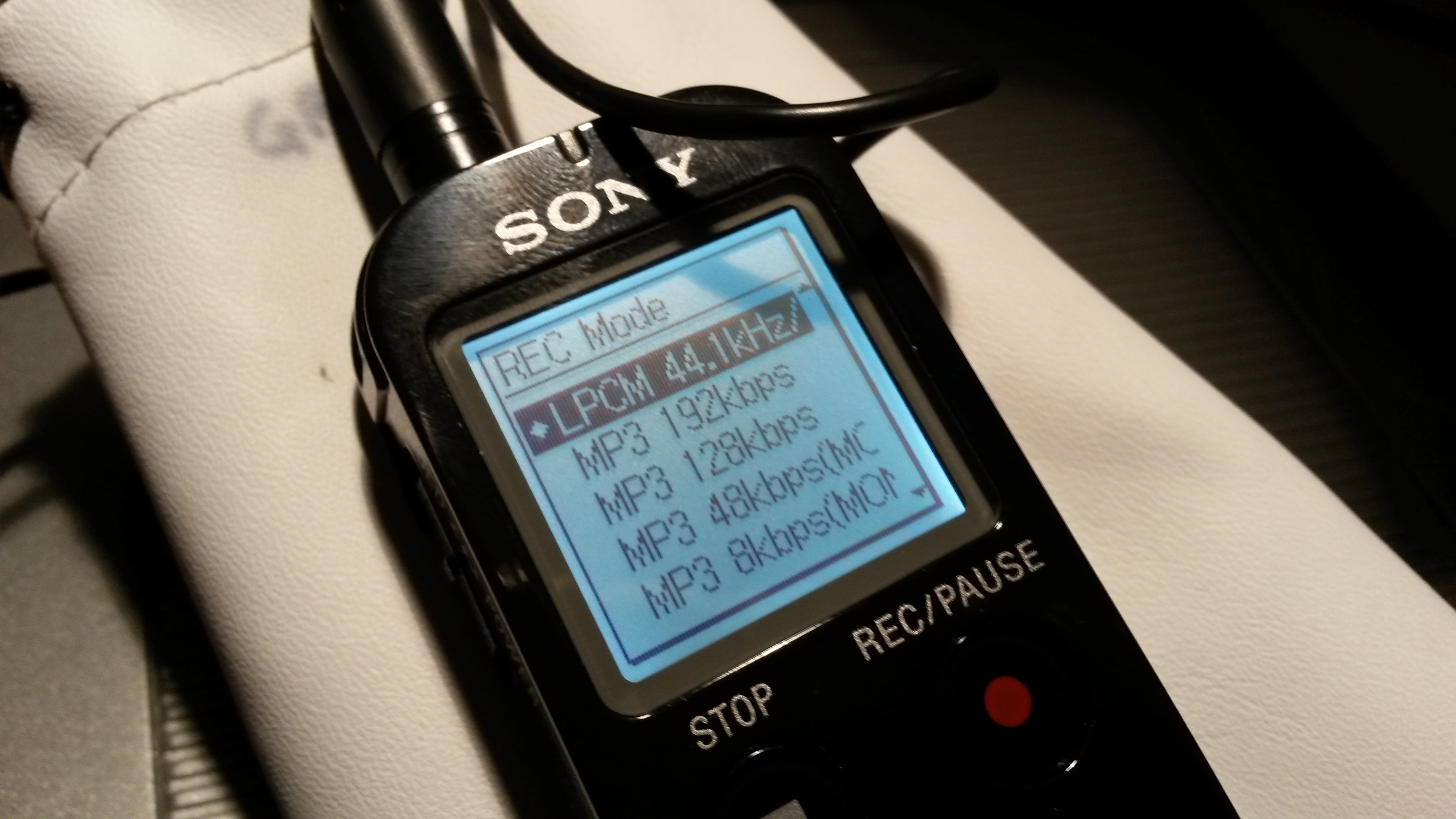

It records LPCM 44.1khz 16bits in WAV format
Having said they're great I've had one stop mid recording even with the hold button enabled - I assumed it was my fault for not recharging the battery but it still had a half charge!
