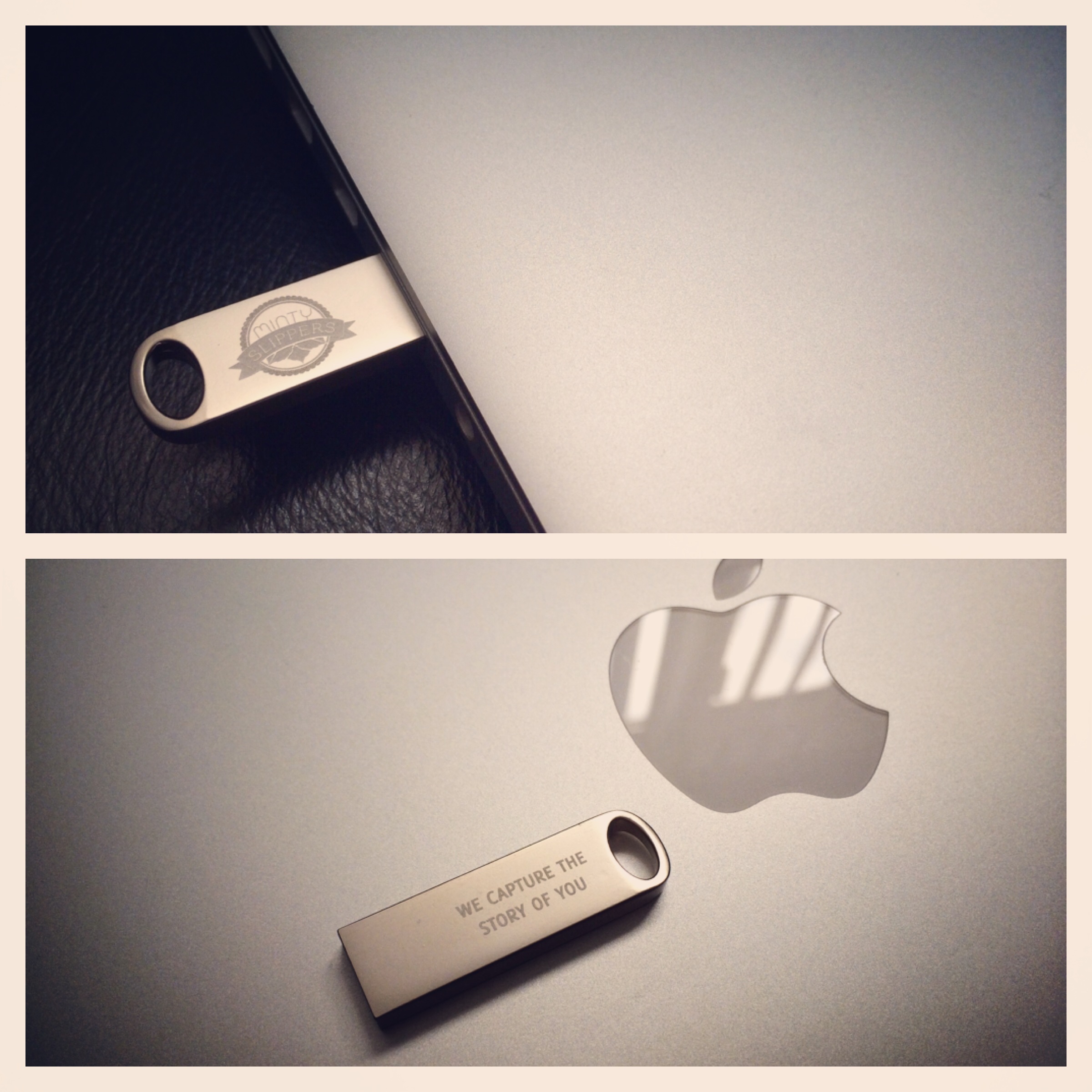

I think our 8GB custom sticks were around £5 per unit when ordering 50 from Flashbay.
Also, don't forget the limitations of using the FAT32 file system on the sticks means your file size will be limited to 4GB. We use this as it means it will work with any computer or smart tv. If you use NTFS your limiting to just windows machines really, eXFAT is great but a lot of TV's wont just work. Ours needed a firmware update before it would read them and even then its a bit flakey.
