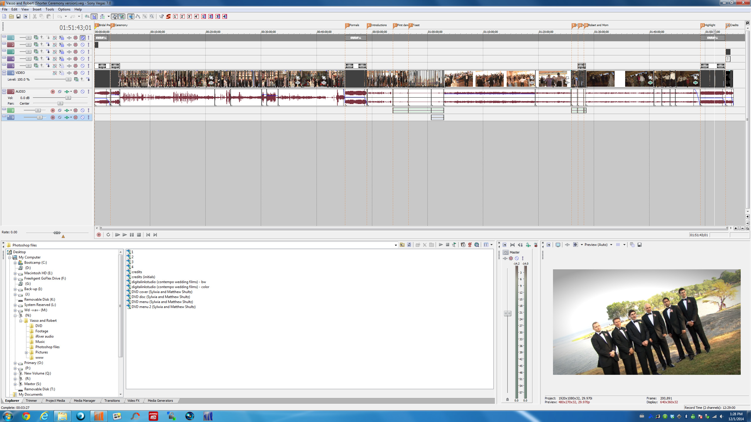

STEP 1: In Vegas with edited project; ready to go.

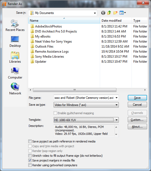

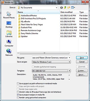

STEP 2: Going to Render As option and rendering the project as .AVI with HD 1080-60i YUV (not sure if that's the best option but I think this is what I used). Should I be going with something else as my output template?
http://www.dvinfo.net/forum/attachme...1&d=1417477126

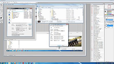

STEP 3: This creates a file (as you can see in the middle of the screen that's about 22 GB in size. You can also see file properties at the bottom.

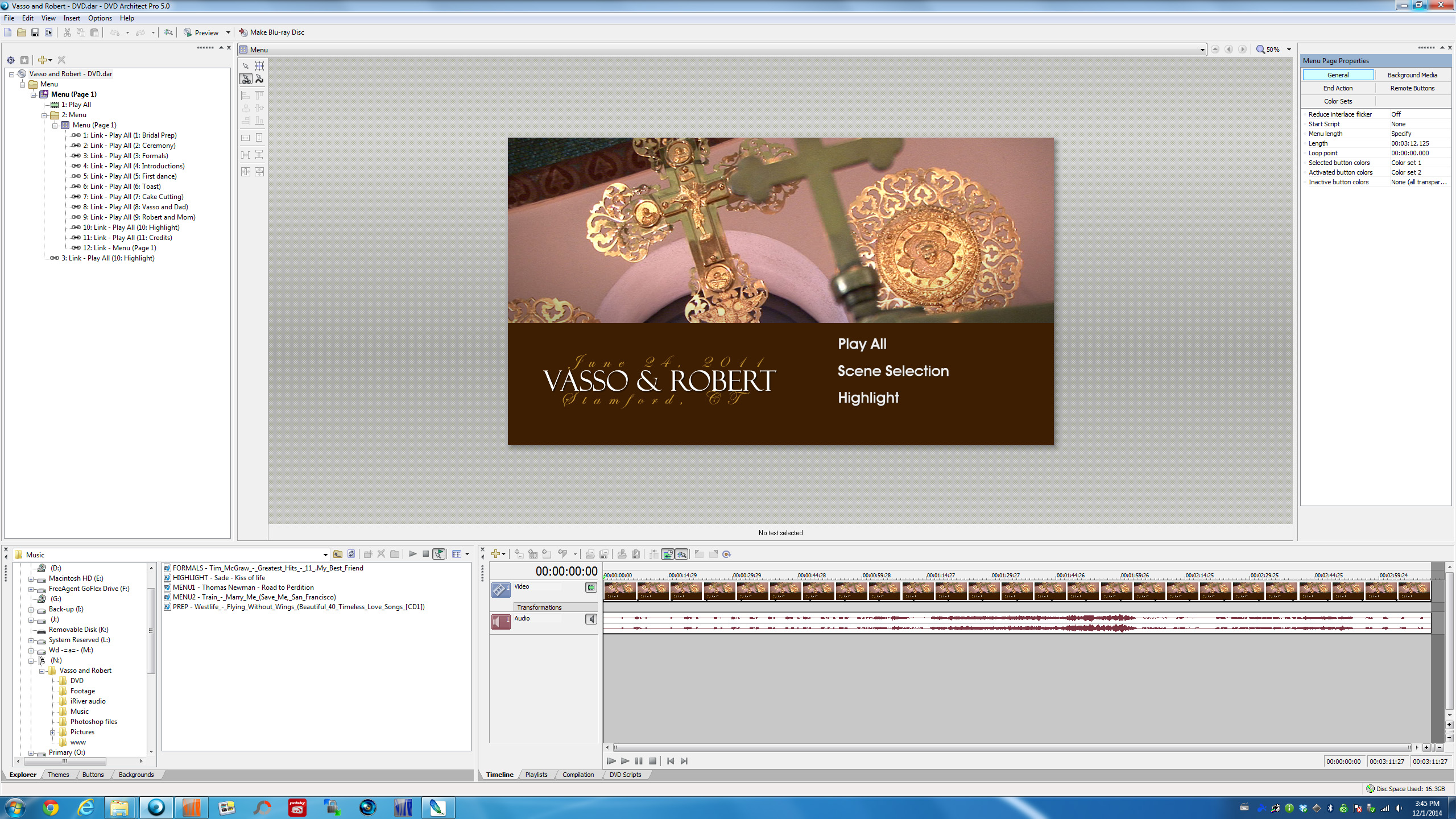

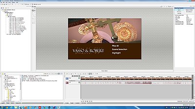

STEP 4: I was able to add the output file to the Architect and do what I needed to do in terms of chapters, music, etc.

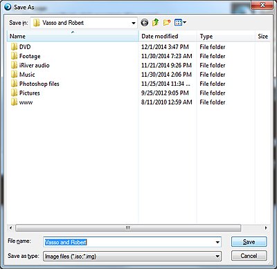

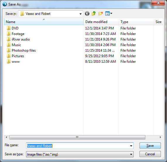

STEP 5: After clicking on Prepare DVD it looks like it's trying to create an ISO file. In the past with standard DVD it would create all necessary files so I'm not sure if this is correct.

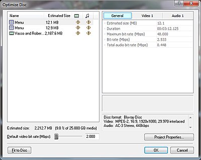

STEP 6: I noticed that it would only take 9% of BD so I clicked on Optimize Disc and noticed that my file is at about 2 GB and the bit rate is at 2.00 by default so I pulled it up to about 30 and then clicked on Fit to Disc.

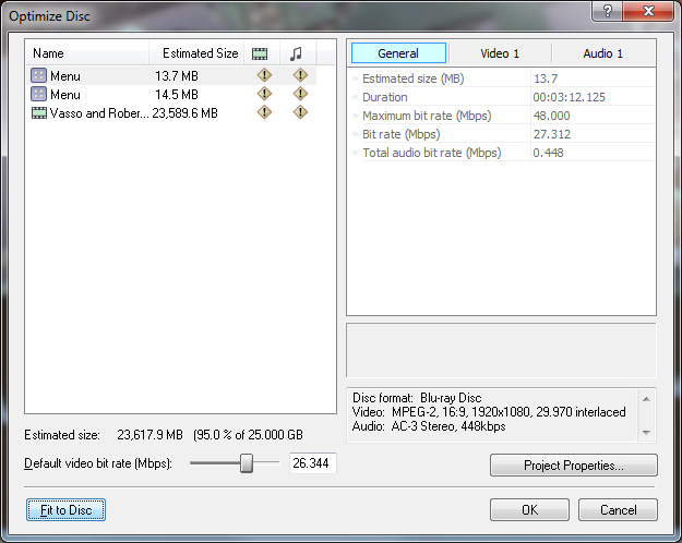

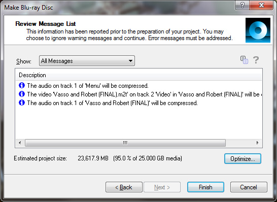

STEP 7: After doing that the file size jumped to 23 GB and the capacity of the disc was 95% of the 25GB available. Is there a good bit rate (Mbps) to go by as a good rule of thumb?

Those Taiyo Yuden discs you are using, the J-BDR-25WPP JVC Taiyo Y disc are classified as LTH (Low to High) discs. It is highly recommended NOT to use BD-R LTH discs for creating Blu-Ray 'video' discs for playback in Blu-Ray players.
LTH is an older technology that enables the manufacturing of BD discs on older DVD manufacturing equipment with minimal cost equipment upgrades. Modern BD players expect to see discs using Phase-change HTL (High to Low) disc technology. I have found very few BD players capable of playing Blu-Ray titles if burnt onto LTH discs. Some players were upgradeable to enable them to play LTH discs but they are few and far between in my experience. I find LTH discs are okay for computer archiving of files but won't go near them for Blu-Ray player playback of 'video' material.

Marcin- for step #2, I render to MainConcept MPEG-2 and then use the Blu-Ray 1920X1080 Template. Then you'll need to render the audio separately using the Dolby Digital AC-3 Pro template. This has worked flawlessly for me. I also had issues with the LTH discs for awhile until I discovered my LG Blu-Ray burner did not support LTH. I was able to download a firmware update for the drive which resolved the issue. I would still use the non-LTH media if possible

This turned out to be almost a week long struggle as I thought I was rendering the files incorrectly. Everything worked as you guys described... down to ISO file. But then when I tried to actually burn the disc I was getting an error ("source files not available"). First though about external hard drive being too slow... then my Mac... so decided to give it a whirl with another Mac and my Samsung drive and learned that there was something up with the drive. Quick run to Best Buy and about hour later I had a new LG drive hooked up and on first attempt it burned everything. Sorry for all the details but maybe this will save someone some time down the road.
