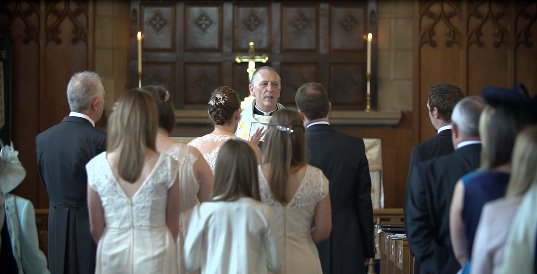

That's a nice shot Steve - I had a priest last year that kept all the bridesmaids stood in the aisle for the entire ceremony - I wasn't allowed at the front so my wide locked off cameras had to fill in!

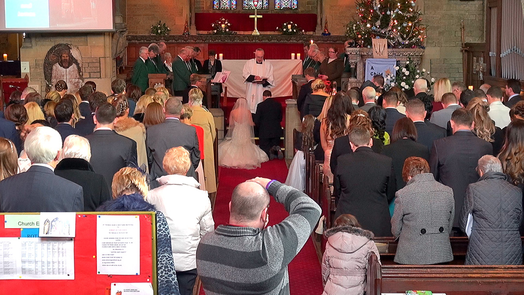

I also get a situation where the second tog stays in the aisle for the entire ceremony - pretty much ruining the shot, even from a high mounted camera like this. They are more work but I prefer balconies for this type of shot now.

Nice to see the photographer dressed for a wedding Pete!!
That is a nightmare Pete, i have Paul my bro ready for that and when that happens he comes to the opposite side of me usually hidden or where ever he can get from a good side view, again if upstairs is available he goes there, sometimes if the tog is in the way then i tell Paul to rub on the togs shoulder and go under or over him, but ye the first pic is a nightmare when the priest does that...

We have the same situations with photogs here ... torn jeans, sneakers and a t-shirt equals "smart casual"
Considering they are in our shots they should at least dress decently! With Church weddings (only a few weddings here are Churches nowdays) IF there is only a centre aisle and it's wide enough and there is no space up front I just have to tuck myself into a pew but I don't like it! Apart from the photog, the guests all seem to lean into the aisle so your shot is blocked anyway.
Pete? Try putting you high angle wide cam right up front with you aisle camera ...that way it just gets the bridal party and front row so the messy aisle shot is avoided. Whenever I can I sneak into the right hand front pew next to the guys so although I have only a side view of the groom I get the bride full on. Our ceremonies here have the couples facing each other so we don't get the "back of heads" shots but Greek weddings still face the priest all the time so I have my main camera behind them.
