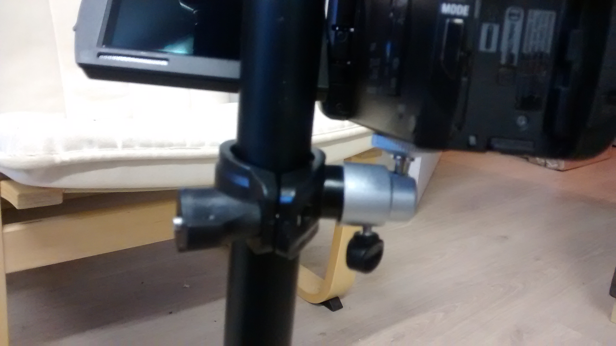

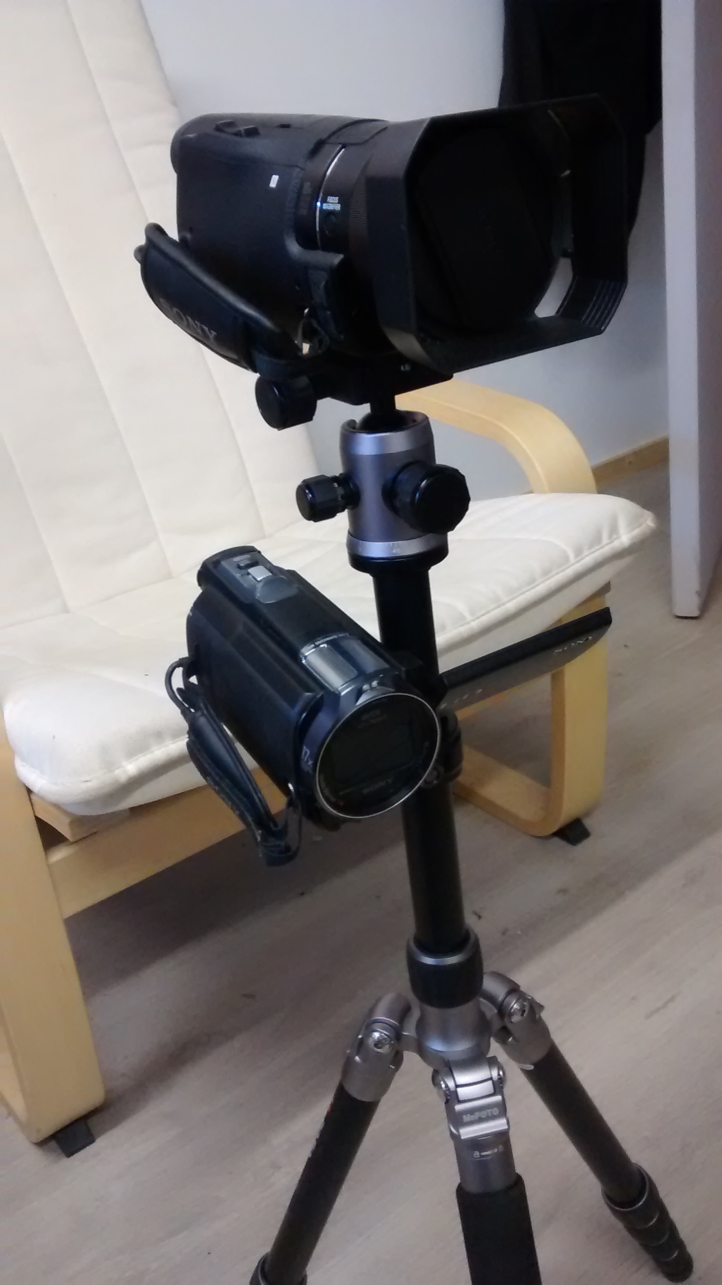

Next wedding I"m going to try out using 2 fixed camera's on one tripod, probably some of you have been doing this for a longer time but I have been thinking about it as I want to keep all as light and simple as possible.
For my fixed camera I use a light mefoto travel tripod, very small folded in, very light but when extended goes up to 1,6m, on this tripod I attach my ax100 to serve as a safetycam during ceremonies so I can have the altar and the lectern in one frame and after wards reframe/zoom in when necessary in post.

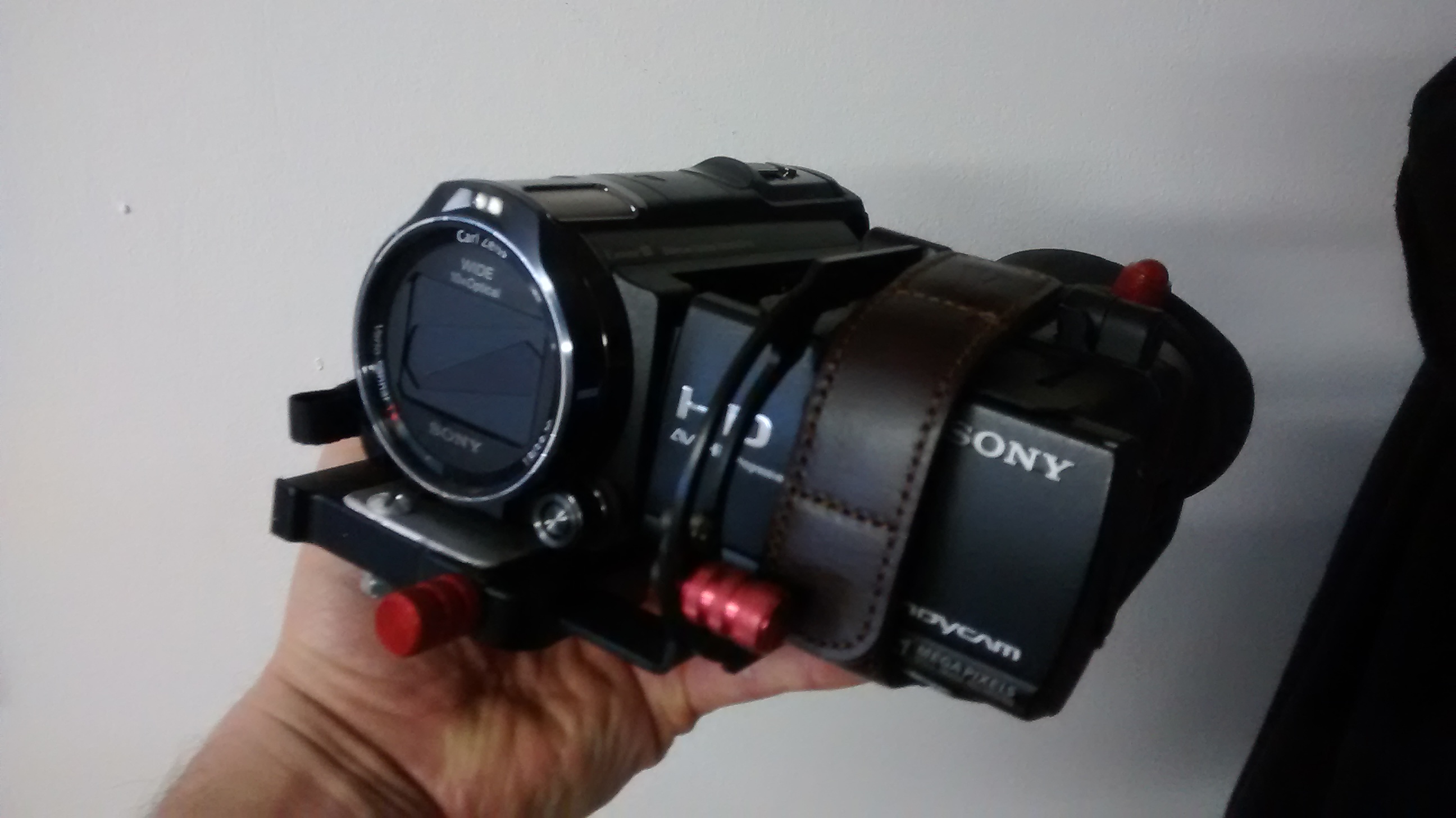

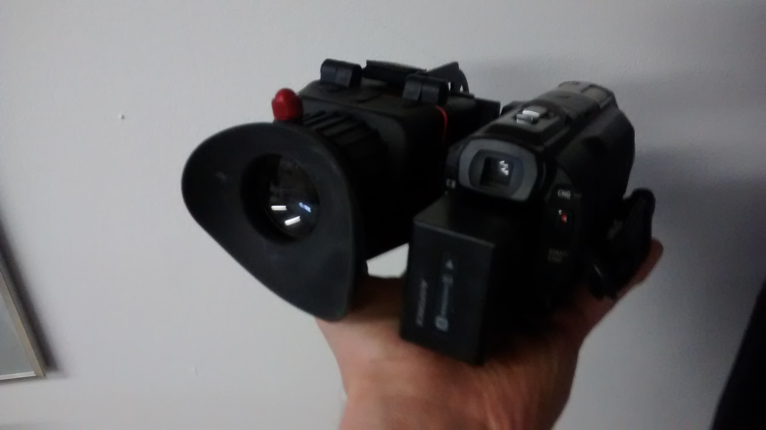

On that same tripod I now attached a smarthphone mount that came with my feiyu g4 but is also able to hold my sony cx730 which I intend to use to zoom in on talking heads at the lectern. Both camera's remain fixed troughout the ceremony while I walk around with a 3rd camera getting b-roll (or is that c-roll? :) while shooting handheld with a cx730 that has a varavon loupe attached to it, see also below photo.
The photos are not so clear and where taken with a phone but you can get the idea, I"m curious though to see how that will work out. Just thought I would share.

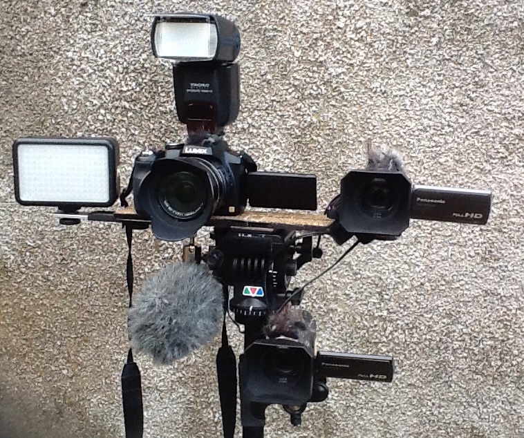

Re: 2 camera's one one tripod
Hi Noa I have been doing this for several years and it gives the ability to move very quickly and be extremely flexible. I use a camera clamp on the tripod shaft, which enable me to quickly unclamp and attach it somewhere else, for instance in the recessional to get them from both ends of the aisle.
Which type of clamp do you use? The smartphone mount I have is ok to carry the weight of my handicam but it looks a bit flimsy, I only fear it might come loose which is why I have secured the camera to my tripod with a short cable wrapped around the camera handle which is attached to the tripod but it's not that ideal.

I've used a Pedco branded clamp, and sometimes the velcro strapped mini-tripods that seem to use some of the same bits. For a while I had some cheap import clamp ones, but not even sure where those are!
You might want to mount the CX to the left of the column, to make it easier to use the LCD? In the one pic it's mounted to the right.
I can't mount it to the other side, the tripodplate hole on the bottom of the camera is off-set to one side and smartphone mount screw doesn't extend far enough from the tripod, it is possible to use the camera like that though but its not ideal.

Posts: 9,512
Will have to look in something like you have Peter, my solution was ok at last wedding but it was very hard to get the camera fixed properly, each time I turned the screw to fasten the tiny ballhead that holds the camera it would tilt up a bit making it difficult to get the right frame.
