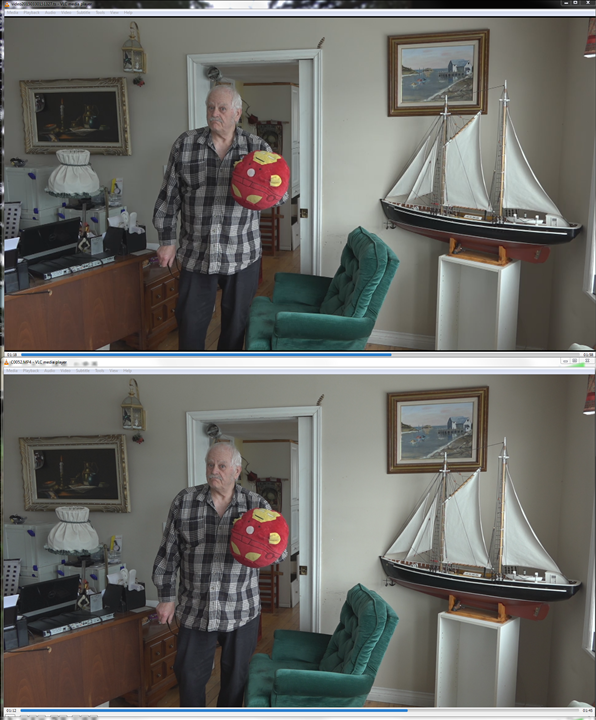

received the zidoo x9 and have it recording the output from the livewedge switcher which is receiving hdmi video from an ax100
I recorded a short bit on the camera in xavc-s hd while also recording on the zidoo x9 and frankly considering the camera clip is 700 mb and the zidoo clip a measly 70mb the clips are similar enough. The h.265 appears more saturated and there are horizontal line issues but good enough for many purposes other than cinema
Top one is from the 100 dollar recorder, screengrab bottom is from the cam
