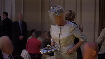

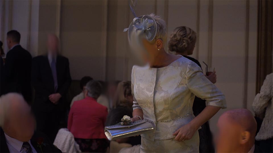

Hi, a couple of the new venues I've been to lately seem to be using LED uplighters in the ceiling to provide ambient light. It looks very nice and all that but it's a nightmare for the cameras. I'm getting very noticeable banding on my A7s, not quite so obvious on the FS100's, but still too noticeable for my liking.
I'm certain a client is going to comment on this eventually. Any ideas what I can do in terms of camera settings or even in post?
For those of those local, it's Galgorm and The Merchant that are most obvious. I'm worried that as more venues are refurbished this is going to become a more frequent issue.
Thanks, M

I've had similar and not just with the A7s but with the NEX EA50 at a venue in Halifax - Awful LED lights all across the ceiling behind drapes - in certain areas of the room I got strobing which I could not resolve despite trying many shutter speeds.

A lot of these have rather strange implementation of PWM dimming - and you may find one of the shutter speeds more friendly to it. However, many different types of LED product may be in action, so some could be made more steady and the others get worse.

I've read that DSLRs are more prone to this than traditional video cameras and cinema cameras. I shot a wedding last year and my 70D picked up an LED flicker but my C100 did not which sounds similar to your experience with the FS100 not showing the flicker.

I always get flicker and banding there. Really annoys me - no shutter speed eliminates it.

And yes Clive, its that new suite upstairs. The Four Seasons suite isn't too bad but the main room in the Merchant has them as well. It's a real pain. I may have add something to my contract or start mentioning it to clients.

I wonder if they are dimmable, and maybe if the dimmer switches were adjusted slightly it might help.
I only got that banding, near the front entrance of the Renaissance Suite, but lighting around teh ceiling edge in main room flickers like crazy when it's ever in shot.

I'd bet they're too bright, so they've been dimmed severely! Some of the newer LED are too bright on DMX level 1 our of 255!

As a lot of you are saying this LED lighting is becoming more and more of an issue for a lot of shooters. Read the following from lighting gaffa David Satz and weep bearing in mind that 0 = no flicker and 99 = massive flicker:
"LED lights
LED lights are different from the classical light sources we discussed so far. LEDs react very fast to voltage changes, even faster than discharge lamps, therefore LEDs are flicker waiting to happen! Similar to the other lights, it depends on the power supply, how strong the flicker is. LEDs usually are supplied by d.c. voltage provided by a mains adapter. Quality adapters generate a very well stabilized voltage, providing flicker-free light. Cheap adapters have a certain ripple, similar to electronic fluorescent ballasts. LED lights can also be operated on transformers or connected in series directly on mains power (for example christmas lights). These lights are flickering intensively.
Serious trouble starts, when LED lights are dimmed. LEDs usually are dimmed by chopping the d.c. supply voltage and varying on and off time. This leads to a massive flicker, even when using quality mains adapters. This not only applies to dimming (for example car stop lights), but also to multicolor LEDs. These LEDs consist of several individual LEDs of different colors. When displaying non-primary colors, the different color channels are dimmed.
For incomprehensible reasons, many manufacturers use frequencies different from the mains frequency for dimming, usually between 30 and 200 Hz. This leads to serious flicker problems, even when shooting on 24 fps! So always measure the flicker factor AND the frequency when shooting with LED lights.
Typical flicker factors of LED lights:
lamp type flicker-factor
LED dimmed at 50%: 99 %
LED on transformers: 40 - 70 %
LED, low cost supply: 0 - 15 %
LED, quality supply: 0 - 3 %"
He has some suggestions on how to minimise the flicker issues with his tables of safe shutter speeds / angles at various frame rates on his web site at:
David Satz - Gaffer, Lighting Designer - About flicker problems
Regardless I still find dimmed LEDs are often a disaster to shoot with in some modern and updated venues. My 1'x1' LED panels have dimmers and are flicker free so flicker free LED lighting can be achieved. Sad but true these venues are obviously driven by the bottom line which often means the cheapest solution and in the process video production requirements don't even get a look in.
