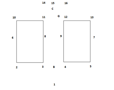

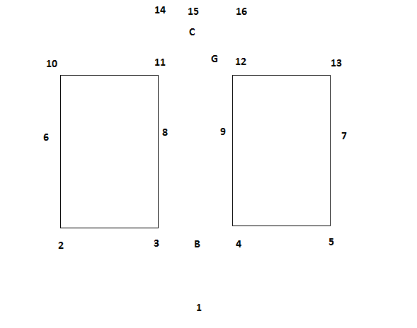

Hi Pete, see diagram below -- some positions for cameras during processional. I think I've used all of them at one point or another. And even this doesn't exhaust the field. In particular, there's lots of things you can do with a moving steadicam camera. In terms of what combination of positions to use for a two-camera ceremony... Well, there's a lot of possibilities. I guess just think about one on bride, one on groom, the cameras shouldn't see each other, don't worry too much about crossing the line, and someone should be in position to cover handover without awkward tripod adjustment. And thinking about lens changes sometimes adds to complexity.
1. So, a camera behind the bride could be a wide angle of everything (in which case it's probably in shot), or a balcony-level camera (in which case it might still be in shot, if you have a monopod guy crouched at position 11 or 12). Or, most popular: could be a steadicam following bride, hopefully crouched behind her so he's not in shot. A steadicam from this position gets the back of the bride's dress, which is often interesting, gets the roof of the church, gets people turning to look at bride, and is in position to neatly cover the handover and hold the shot till other shooter is set up on tripod. Disadvantage of this position for two-camera shoot: it's not a close-up groom camera.
2 and 5 -- probably most useful as a wide angle, the point being to show the bigness of the church, and all the people standing up.
Position 3 -- either a wide angle that perhaps could be locked off for the entire ceremony, or sometimes people post a 70-200 or similar here, so that you can get a shot of groom's face over bride's shoulder. You can also have someone do a panning shot, exposure permitting -- following bride as she walks along back of church and then turns into aisle. Position 3 is more useful than 4 for catching groom's expression, but which side you stick a camera on depends on layout and which direction bride is coming from. If used for main wide angle during ceremony, it has a clearer view than 2 or 5.
Position 6 -- if it's a high angle (to see over heads), can be surprisingly good shot for various purposes. Often it's useful to get groom first look, where otherwise you'd be blocked by people standing up. But if it's really high, you can also use it to track the bride as she walks down aisle, up to and including the handover. If it's not a big close-up, then all the people filling the frame can add to the interest of the image.
Position 7 -- This is the wrong side for a groom first look, but this position from a high angle can be useful as an unmanned wide angle depending on layout of church. Can later reposition it as an aisle cam.
Position 8 -- One trick I use is to place a sign on one of the pews saying "Reserved for videographer". If you have someone standing here, they can get a groom first look, including over the bride's shoulder, can cover the handover without getting blocked, and can step into the aisle for the rest of the ceremony. Can start with tripod with the legs folded up, to use it as a monopod, and then unfurl it once they step into the aisle. In some churches, there's a pathway between pews that you can stand or crouch in instead. Note: sometimes people use 8 or 9 to film bride instead of filming from front of church.
Position 9 -- Depending on layout, can sometimes be useful.
Position 10 -- obvious place to put a groom camera depending on how far forward the groom is standing. If there's space between the altar and the first pew, then you won't just be looking at the side of his face.
Position 11 -- some people stand, some crouch. Obviously a good place to catch either groom first look or bride. One disadvantage is you might get in shot of other cameras, depending on what they're doing. Another disadavantage is that your movement might be limited to relocating to position 10 after processional, although position 13 is often more desirable for the sake of getting an angle that favours the bride.
Position 12 -- classic position from which to get crouch shot, or standing shot, or even high angle, of processional. Usually can't get much of groom from this position though. Main point of this position: you get a full-length shot of front of dress, which might be tricky to get from any other position.
Position 13 -- not useful as a groom cam, but can be used as a high angle to track bride into handover. Can set it up as a timelapse before ceremony to show guests arriving.
Positions 14 and 16 -- very often used for something like Greek ceremony, where couple are faced away from audience for most of it. Position 16 has the advantage of favouring the bride and being able to get a groom over-the-shoulder of processional, but, depending on position of signing table, might not be ideal. The other problem with 14-16 is that they're often in the view of a camera from the other side, especially if they're shooting diagonally opposite each other.
Position 15 -- you're unlikely to be in this position, since you'll probably spoil the view of any other camera, except perhaps for a something like a Jewish wedding, where, under a small chuppah, you might not be able to see the couple otherwise. Outside weddings might give you more freedom. Photographers once in a blue moon try to get a shot from here during the kiss, because it's epic to see all the people cheering in the background with the kiss in the foreground.

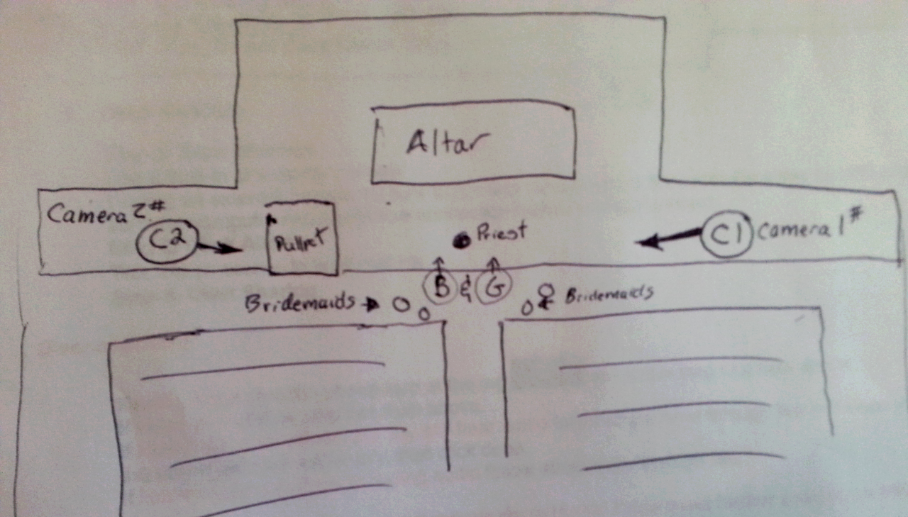

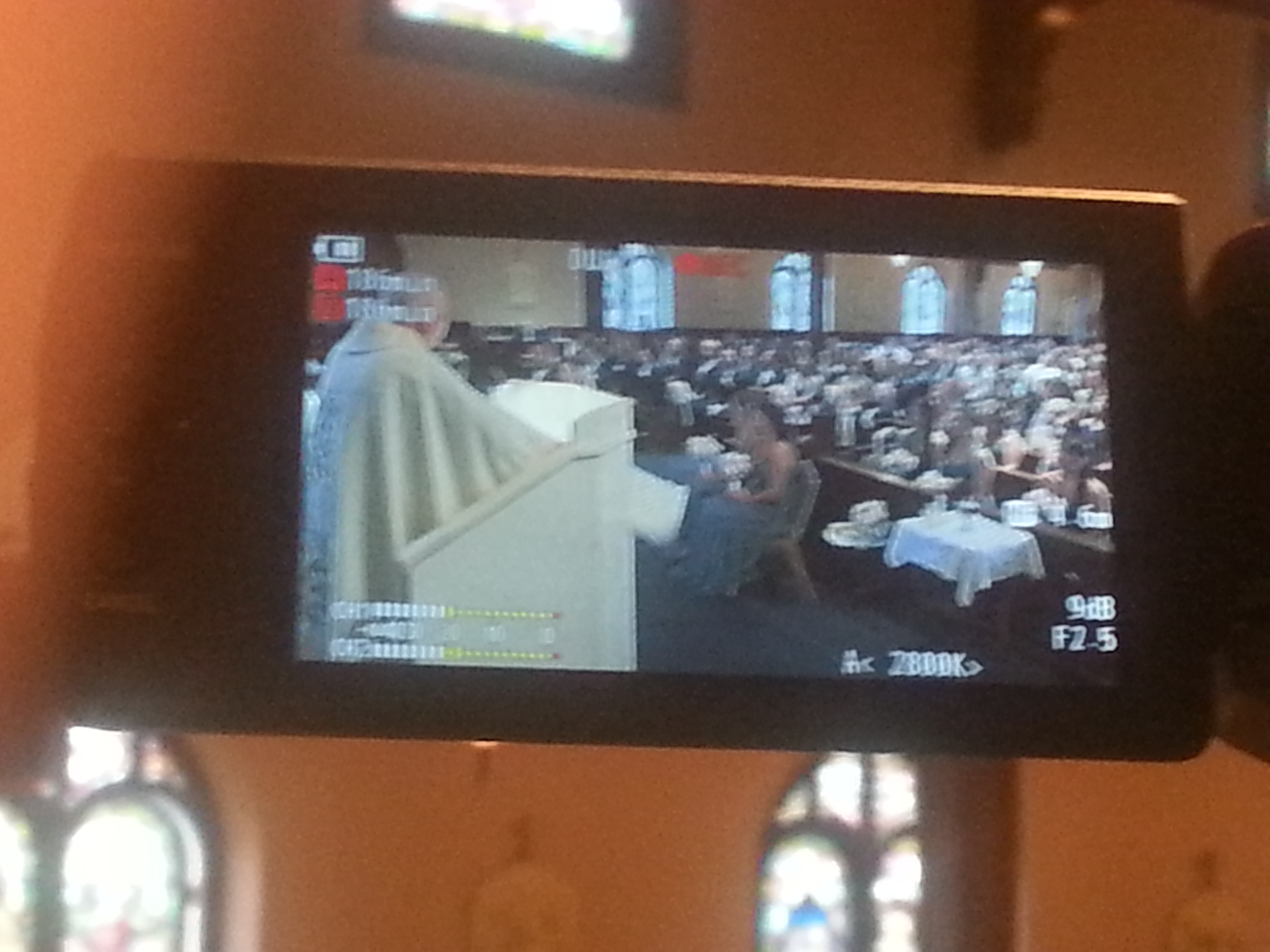

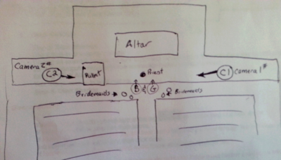

I just did a wedding. The priest would only allow us on the edges. It was difficult to shoot over the pulpit and both camera got each other in the shot when we were wide. Any other location would show the b&g backs of their heads. The shot shows when priest was at the pulpit I was able to get closer during the vows but it was challenging to get over the shoulder of face of each.The b &g heads are just above the pulpit.
Wedding camera placement-2015-06-22-15.38.43.png   Wedding camera placement-20150620_143502.jpg
Old June 22nd, 2015, 04:20 PM   #12
Join Date: Oct 2012
Location: Sydney, Australia
Posts: 1,149
Re: Wedding camera placement
I guess in that sort of scenario, where B&G are facing away from audience for most of the ceremony, I usually try to put one camera on the "inside", and one in the aisle (to get the faces of priest and other readers).
In your case, you couldn't shoot from the aisle. But could you have shot from the edges, over the heads of the audience, to get more of the priest's face? Or would your zoom have been long enough to shoot from the back of the audience?
In really dire situations, that's when having more than two cameras comes in handy -- could be unmanned camera or even GoPro time. I think Peter Riding uses this sort of trick -- clamps prefocused unmanned cameras all over the place.

This was a wedding that I was hired as a 2nd shooter not the one I created this thread for. I left it in the hands of the guy who hired me. His priority was for me to be in position for the vows covering the closeup of the groom while he did the bride. I did move out to the aisle and reverse my direction to each speaker. The guy who hired me was flying on seat of his pants. I took that pic with my phone and txted him so he had an idea what i was filming. Hard for me to say whether the client is that concerned with seeing the priest's face. The other thing I was conscience of when I move out in front I was directly in the field of view of the other camera.
