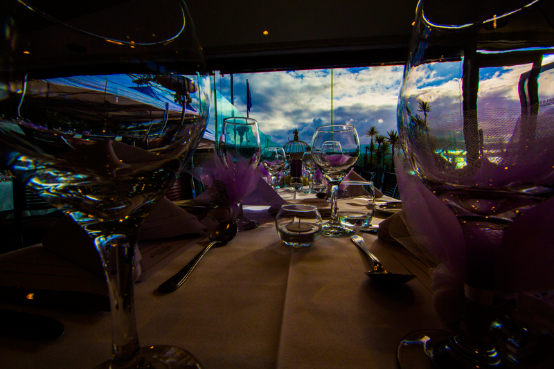

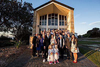

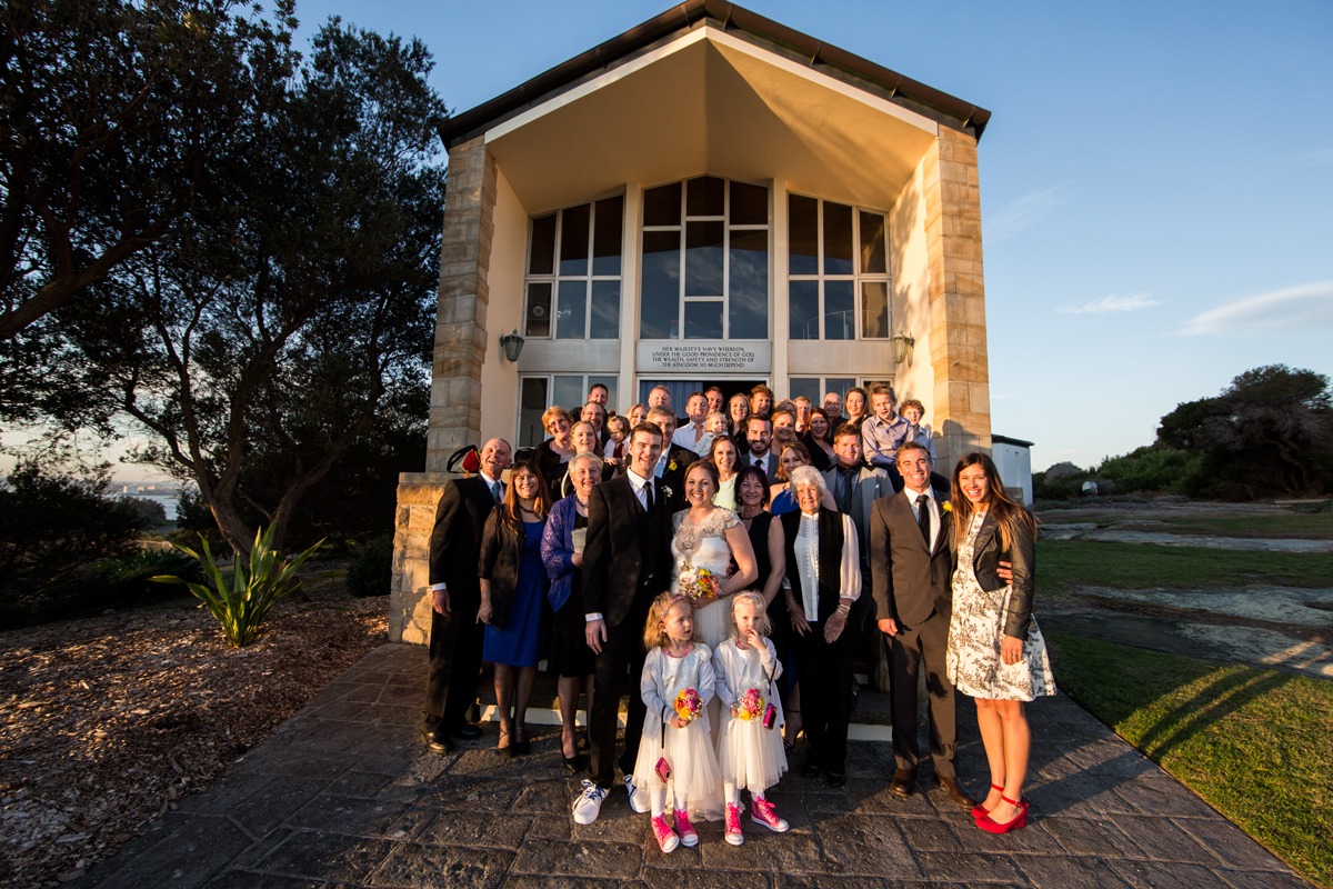

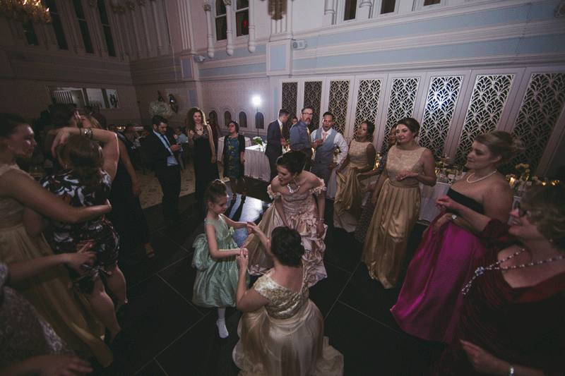

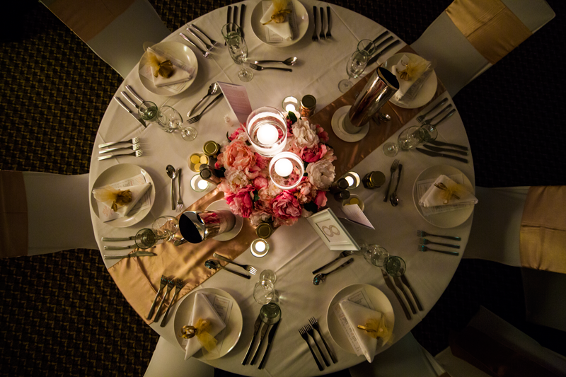

Don't know if it's helpful... had a quick look around my computer for dancing floor samples, but didn't come up with much. But, for what it's worth, here's some of my general pics at 14mm anyway... Note the distorted people towards sides of first and fourth pic, and distorted wine glasses in second -- anything towards the edge of frame is going to distort, particularly if it's close to you. In the third photo, of the table arrangement, notice how the upright metal water jugs seem to peel away from centre, presumably because I was shooting at a slight angle rather than straight down, but their angle of tilt does seem to be exaggerated. In the last photo, notice the strangely skinny church; not entirely sure why it looks skinny; it's partly to do with the lens somehow making it seem like the nine people at the front of the crowd are the width of the church (which maybe is the same kind of fisheye effect you see with the table arrangement); and I think it's also partly to do with the field of view being wider than the human eye (I might be very wrong, but I think the normal human field of view is probably somewhere around 21mm, with 35mm being the "active" area).
